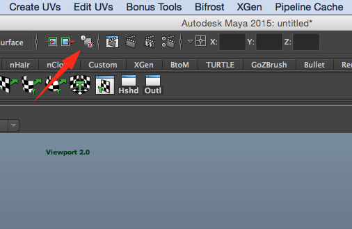

i was working on maya 2014 everything was perfect and then i wanted to make a normal polygon .. i can't find INPUT in the channel box so i can add subdivisions .. i know i can add subdivions from another area but why its not there ? .. i maybe used to click on shapes on channel box and all the subdivions used to come right away but now no 😞

For problem 1 - You have your construction history turned off.  Click on the icon at the top of your screen shown below to turn it back on.

man if anything i can do to thank u enough tell me 😄
you saved my life my respected master .. thanks a lot .. best luck for u 🙂
