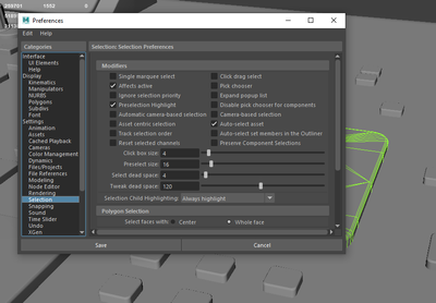

I'm having a problem with Maya 2022.
When I'm in component mode and select a vertex, edge, or face, then switch to object mode, Maya keeps selecting the component while also going into object mode.
As a result, when I try to move or scale the object, it ends up moving or scaling both the selected component and the entire object.
How to fix this issue? Thanks.

Turn on "Preserve Component Selections" in your Selection preferences. That option should have been on by default.
