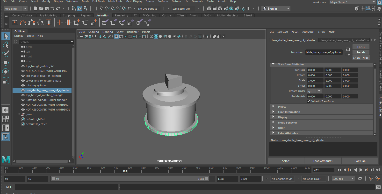

Hello AutoDesk friends,
Being a newbie, I am currently using Windows Maya 2018, where I have created a 3D cylinder wanting it to rotate 360 degrees displaying a logo.
Having viewed and researched all available resources, I have come up with using a turntable which does the work for me.
However, even though the cylinder is indeed rotating 360 degrees, once I play the animation preview, it rotates at a certain designated speed (50), and as soon as it is supposed to cycle back and continue its forever rotation, it slows down the rotation speed arriving towards the end of the timeline and at a slow pace picks up the continuity of the rotation back from the begging of the timeline instead of making it flow as one continuing piece.
I have played with graph editor and it’s tangents menu, putting everything I could find under “linear”, such as ‘In Tangent and out Tangent’ but the same result happens.
First off, once on graph editor, it says that I should have a curve line, mine is a short horizontal straight pink line with an infinite red perpendicular line crossing it.
May you please assist me with something I am missing to have a continuos preview of the cylinder rotating 350 degrees upon itself.
If you need some more detailed information about the object and it’s specific references, I am ready to add them to this note.
Thank you very much for your assistance on this matter!!
- HB

Message 2 of 15
mspeer
Hi!
1. Your Maya version?
2. For turntable a camera will be created that moves around your scene. Select the animated group (transform node) for this camera to get your keyframes.
I recommend to animate the Cylinder as this gives your more freedom with your camera.

Thank you for your quick reply mspeer,
VERSION: WINDOWS AUTODESK MAYA 2018 (What exactly were you referring to here, is there a version number or something?)
Actually the selected cylinder to rotate is the only piece of the large object rotating as you can see in the image below.
I will research how to use the “transform node” and see how it affects the way the camera uses the keyframes.
The preview of the cylinder is rotating 360 degrees perfectly fine, but since I want it to be a continuous rotation, it pauses the video toward keyframe #1195 (view on image below) for 1 millisecond and starts over again at #50 breaking the flow instead of an uninterrupted steady non stop replay.
Maybe I’m not doing the tangents/linear thing right, may you please explain how to execute those options?
Attachment #1: The whole object, with the selected cylinder in green which rotates
Attachment #2:  The Graph Editor based on the cylinder turntable

Message 5 of 15
Hello mspeer,
Thank you for your input on not needed so many frames.  I reduced it based on following the cylinder’s rotation which makes a complete 360 degree, and blocking the timeframe from start to finish of the cycle.
Also, thank you for the 'Post Infinity' which makes it a consistent rotation.

Message 6 of 15
mspeer
Hi!
Turntable does not rotate the objects, your objects don't move.
Your camera named turntableCamera is moving around the scene (enable Grid and you see the problem).
It seems you are not very familiar with Maya, so i don't recommend to use this feature.
1. Switch back to persp camera in Viewport.
2. Simply select the object you want to rotate and create 2 keys at separate frames for Rotate Y.
Please read the Maya Online Help / Documentation for more details about keys and animation.
