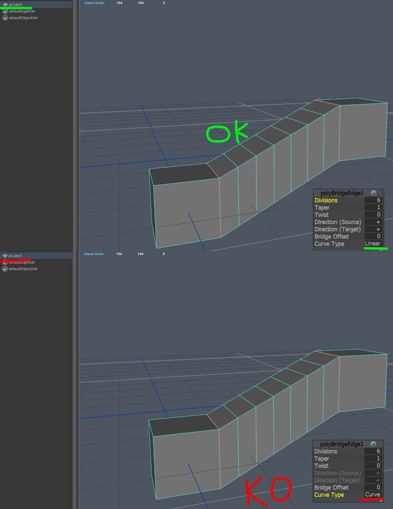

When I use the "bridge tool", the "curve Type" option in the float menù don't work correctly.
If I use the "blend" option or switch to "Linear" work fine, while if I use or switch to "curve" the tool don't work and don't create a curve in the outliner.
Maya 2022.1

you must run bridge with checkbox. and there choose smooth path + curve

The in-view editor is just modifying values on the bridge node. (like the channel box or attribute editor)
So if the bridge was not created with the smooth + curve curve option then toggling that attribute won't add the curve. (but you could argue we should hide that option if the bridge doesn't have a curve)
