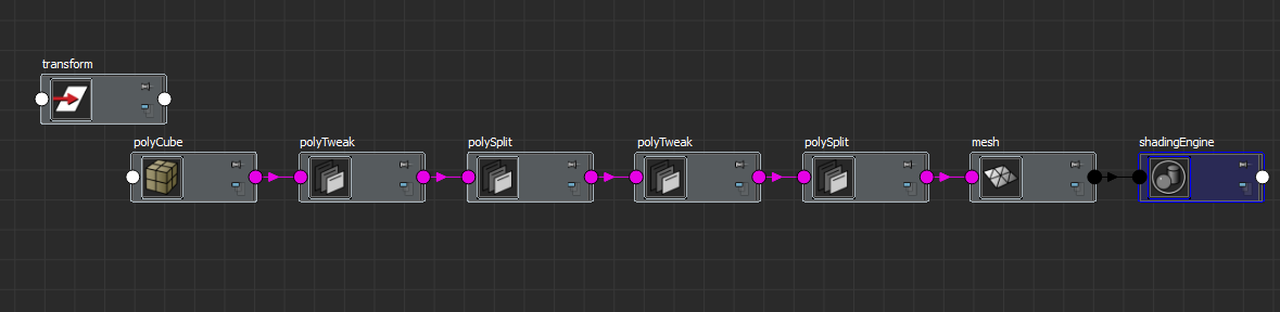

hi, a question about Node editor, is it possible to "bake" the geometry up to selected nodes only?
for example, I have this node chain =
and I want to bake the changes (basically deleting history) but only until the first polysplit node. (the one I marked with red arrow in the image below=
the reason is that I need to delete history to speed up my viewport,  but I dont want to delete the entire history (basically I want to keep the history of 2 - 3 latest command)
is there a way to do it?

if you use maya 2015 or below the easy answer is yes. download maya bonus tools. once loaded there is the possibility in modeling > mesh history edit > delete upstream mesh history.
i´m not very deep into this stuff since i don´t really need it often but was curious so i tried a manual way which could look like this:splitHistory.jpg
hi, thanks for the reply, I guess that trick works 🙂 thanks very much. also I can just use instance when duplicating the object, with 1 transform node it allows me to keep my original history as separate geometry in which I can still reconnect it anytime if I want to make changes to the earlier history, then save it to "back up" layer.
