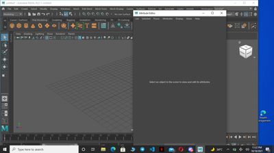

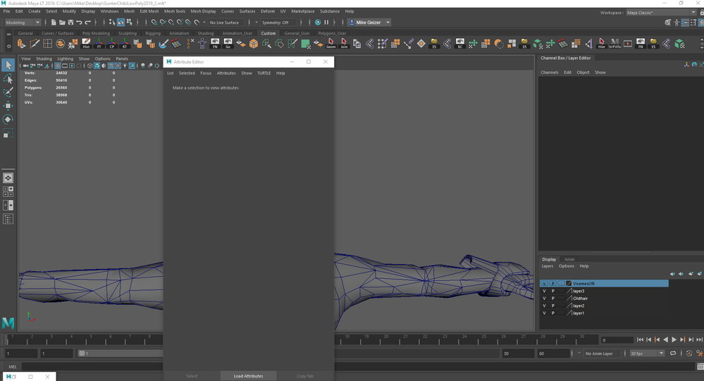

At some point I pulled my attribute editor out like in the image below. I'd like to get it back on the side, alternating with Ctrl+a like I am used to, but dragging it over there just puts it beside the channel box. I tried resetting my settings in preferences but that didn't help. Any idea where I am supposed to drag it?

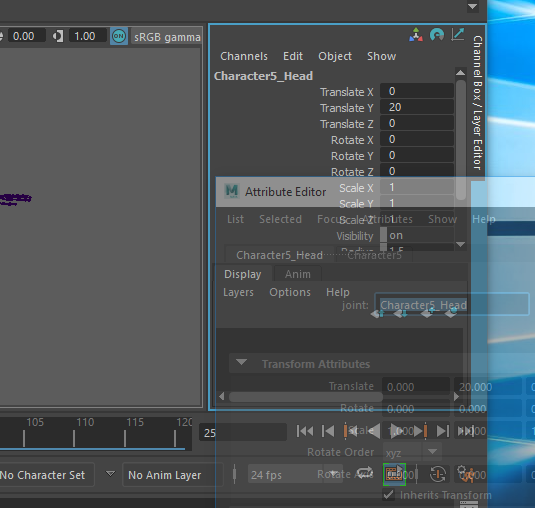

Hi @Mechlai,
You'll want to carefully drag the attribute window to the right side of your Maya window. At that point the sidebar with outline in blue, showing you where the window will be planted. I've attached a picture of what this will look like. Make sure to keep holding down LMB until you're satisfied with where it will end up!

I still haven't been able to figure it out.
I've attached a picture of what happens when I do that. I don't want it to be beside my channel box. I want it to alternate with it when I hit ctrl + a
https://gyazo.com/6b6ad9e03694dd48b3e24cddcceb0c29
alec.andersenLP8AU
hi @Mechlai,
There's a few options that are all rather close together, so you must be careful as to exactly where the blue outline is displaying. In the example screenshot I provided, note the thicker blue bar below the channel box tab. This indicates that the attribute editor window will be put into that same window, in a different tab.
