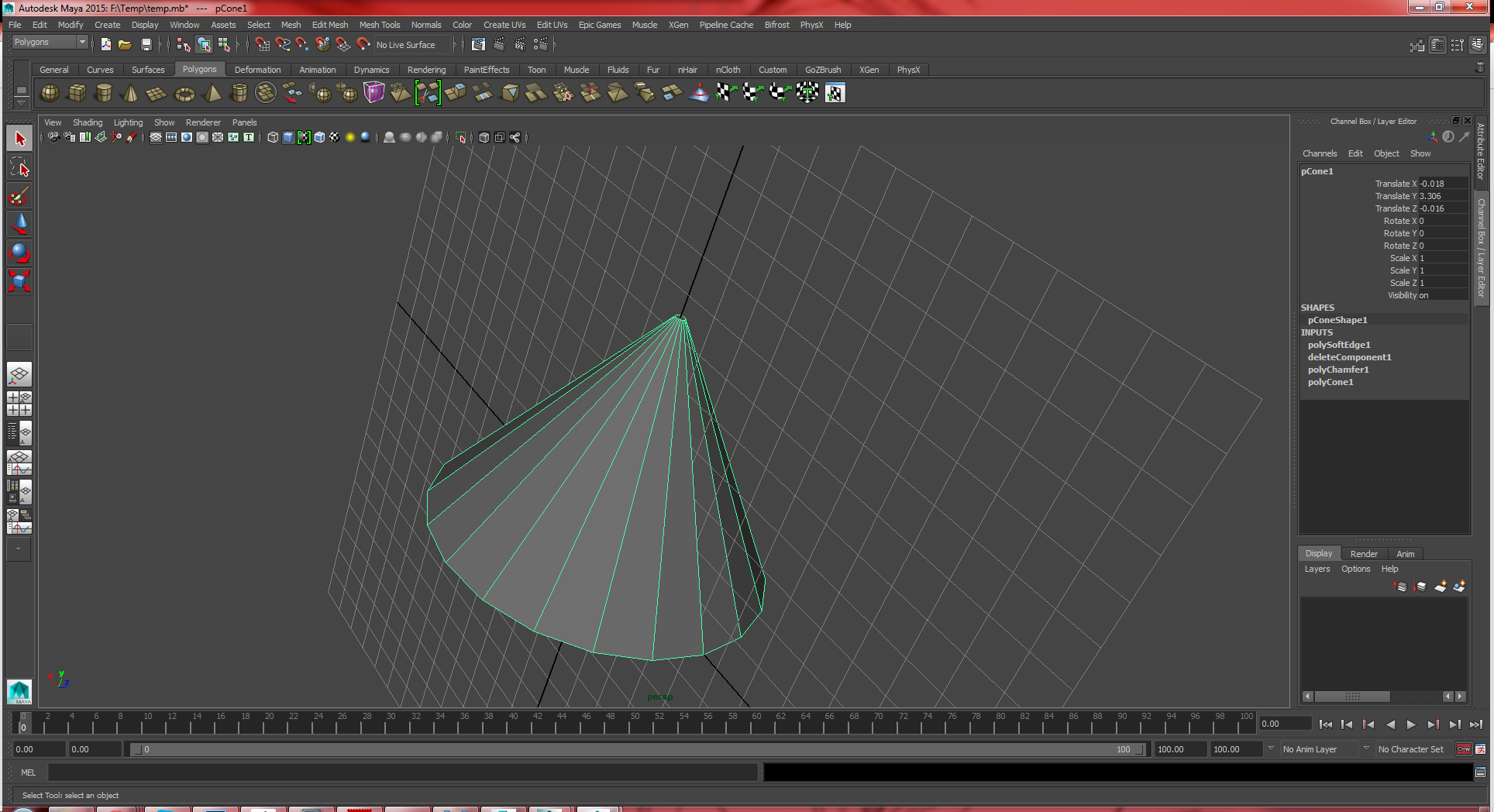

It seems like the orientation of the scene in my viewport is off in Maya 2015. It's problematic especially when I try to export my mesh into another software, or when I'm trying to import a mesh into Maya.
There's probably a setting I missed to fix this issue.

And here's the same scene in Maya 2015 :
MAYA 2015

Just reset your settings or something.
You've probably made something "Live" or "Orient Camera to Polygon" or something...
I would just delete my preferences and open Maya again.
It seems it has been fixed, thank you for the help 😉
