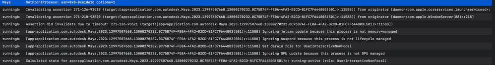

When I attempt to use the comb tool in maya i get the following message:
XgmSetCombBrushTool;
// Warning: XGen(Tip): OpenCL is disabled. See output window for more details.
I tried the following, but did not work:
-  reset prefs folder
- found the maya.env folder but there was not any code it was a blank file (one forum said to open this file and make sure "MAYA_DISABLE_OPENCL=1" was not in there or to alter it to equal 0 or delete it)
- i opened maya with the terminal so i could view output messages in the console searching for only maya processes and when clicking the comb tool would get the following message from maya
SetFrontProcess: asn=0x0-0xe1de1d options=1
This is some other message that get output but the process is from the runningboard:
If anyone has any idea how to fix the issue that would much appreciated, thanks ahead of time!

I am also having this problem, did you find a solution?
salm1027
in reply to: itsevaneggers
Hey there,
I never found a fix for this. I just gave up on the hair. However, I think in maya 2024 this problem is fixed, whatever the problem was i will never know. Which maya version are you using?
itsevaneggers
in reply to: salm1027
I was using 2023, but just tried 2024 and it seems to be working!
