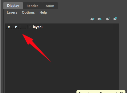

Hi creative people. I'm having an issue with viewport 2.0. When I playback my animated mesh disappears from the viewport, just on playback. I try changing to Direct X but, same thing. I animated using Legacy, but, it is a strange and very annoying problem, any idea ? Thanks you guys in advance. Cheers.

If you're using a display layer, turn off the "P" flag. (That flag means "hide on playback.")
HI. thanks for your reply, but the problem persist. I will check my reference file. Cheers.
I have the same issue. I lose my object when scrubbing through the animated timeline. Removing the flag (p) does not work.

Sorry...I actually said that backwards. Having the P flag on means visible during playback. Turning it off should make the object invisible during playback and scrubbing. Also...note that that flag is only compatible with Viewport 2.0.
Uh duh, haha! you are right, i had it backwards!!! "P" needs to be on, lol
