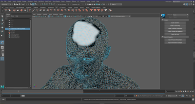

As per the title, I am unable to properly paint nCloth vertex maps, no matter what type of file settings I use.  I am a novice when it comes to Maya so I am not too surprised that I can't figure out what could be going wrong, but I've hit quite the brick wall when it comes to what I'm trying to achieve.  Upon attempting to paint my vertex map, the mesh turns white and I am unable to paint anything.  There are times that I have gotten the mesh to turn black and I was able to paint, but I am under the impression that it is unrelated to the nCloth vertex map I am seeking to paint.
This is the result of me attempting to paint the vertex map.

I believe the artist from the video may be using the cntrl key to paint away (black). It essentially casts the value of the Paint nCloth Attribute Tool to 0 without having to open the actual tools options and manually change the value. Try that and see if that helps.

That COULD be a hardware issue, as, by default, you should have seen color feedback update, impossible to tell from a mere screenshot. Try saving file, exiting Maya, reopening scene.
Also, to understand why you couldn't paint white (100%) over white (100%), you would read the Help article on nCloth attr map idea. Pressing Ctrl while painting reverses the Value of the "paint", not the painting Operation.

MakePaintable is for PaintFX, nothing to do cloth.
Your vid proved nothing about impaintability of the mesh, because
1) Smooth: takes two neighboring values and decreases the contrast, in your case (100%+100%)/2 = 100%;
2) Add: 100%+100% = 200%, however, since 100% here is maximum the result is 100%;
3) Scale: 100%*100% = 10000%, however, since 100% here is maximum the result is 100%;
4) Replace: 100% replaced with 100% gives 100%.
Would be hard to expect anything else.
Have you tried to touch the Value slider? Decrease the value to 0.5 and try again all the paint Operations; try Flood button.
Regarding the "noisy texture", unless you had loaded some cloth preset, like, Denim, the noise rather LOOKS like a hardware glitch, and all you do is just redraw the area, which appears like something else, but it isn't. Can't test your scene, as the alembic cache is linked to the folder outside the project, and M2019 I have doesn't supporting relinking alembic.

Adjusting the slider to 0 did the trick, thank you so much! I apologize for any confusion I may have caused, like I said I'm a total Maya noob.  Once again, thank you for your quick responses and coherent suggestions, I am truly grateful.
