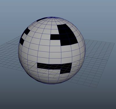

So I'm trying to select faces which have their normals flipped.
Like this example....
I've tried setting the 'Mesh Component Display' to Full seen here and then marquee selecting but it selects the faces anyway.
I've also tried splitting the model in the UV editor and selecting front face...which is close but doesn't work still.
I'm sure I'm doing something silly or maybe it can't be done.
My main goal is to be able to select all the faces on a model which have flipped normals. The example above is very simple but I want to do this on much more complex models.
Thanks to anyone who can help.

Try conform normals.
Message 3 of 14
keith112
Thanks for the reply.
Conform definitely would work to flip the UV's on the sphere and maybe other models.
However my main goal is to select all the flipped faces. This is needed for further work down the pipeline.
Its quite long to explain but maybe explaining exactly why I need might shed some light?
Message 4 of 14
damaggio
Okay then, that’s the only solution in Maya.
try it manually.
conform flips the faces .
Message 5 of 14
keith112
****. Thanks anyway

mspeer
Hi!
@keith112
If the faces only should be selected you can try
1. Select all faces (face selection mode) of the object, then
2. Use Conform as suggested by @damaggio
3. Use Reverse
This will end up with the faces being reversed again, but selected.

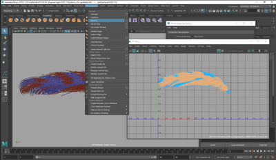

Sorry about the late reply, but I was searching for a solution to this problem, and find it by myself.
Select all the faces from the object with some flipped faces, then go to Mesh Display>Set To Face. Under the tool options select Match face normal. Ta-da! It works for me.

DOOOD.  YES.
I've been staring at this all day trying to find the solution...
I seem to rememeber maya had Backfacing as a selection mask at one point, but maybe not...
I saw the Back-Facing selection constraint in the UV editor for none of my shells were reveresed...Didnt think to do a planar mapping and then use that to select the back faces...Might not work for everyone, but perfect for me.
