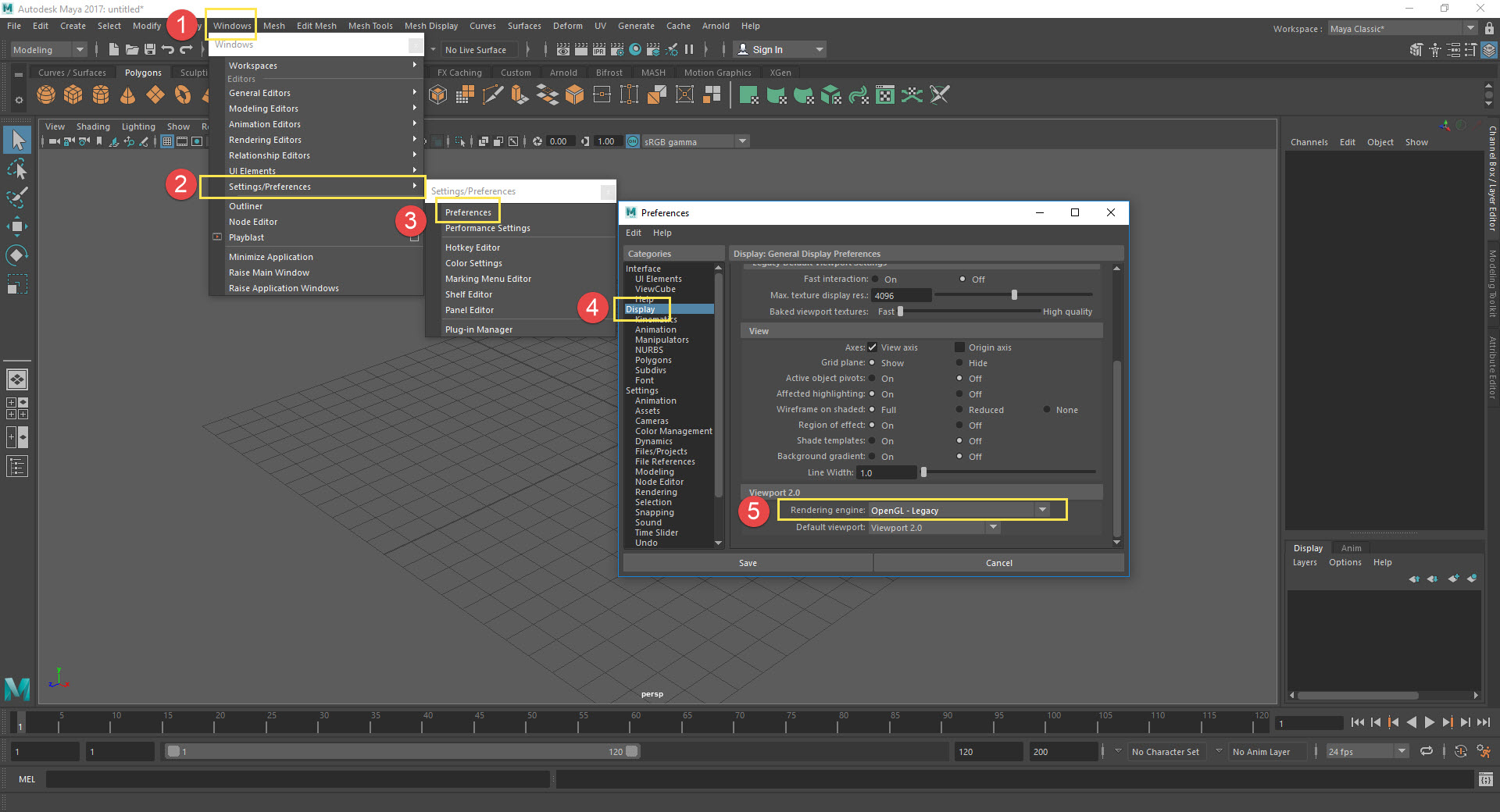

  2. Set viewport renderer to be DirectX not OpenGL
    • To change this setting, navigate to Windows > Settings/Preferences > Preferences > Display > Scroll down, and select DirectX from the Rendering Engine drop-down menu

On my windows there is no Preference setting
sean.heasley
Hi @Anonymous
Can you post a screenshot of that not option not being there?
This is a basic menu dropdown in Maya and should be there for every version of Maya.
