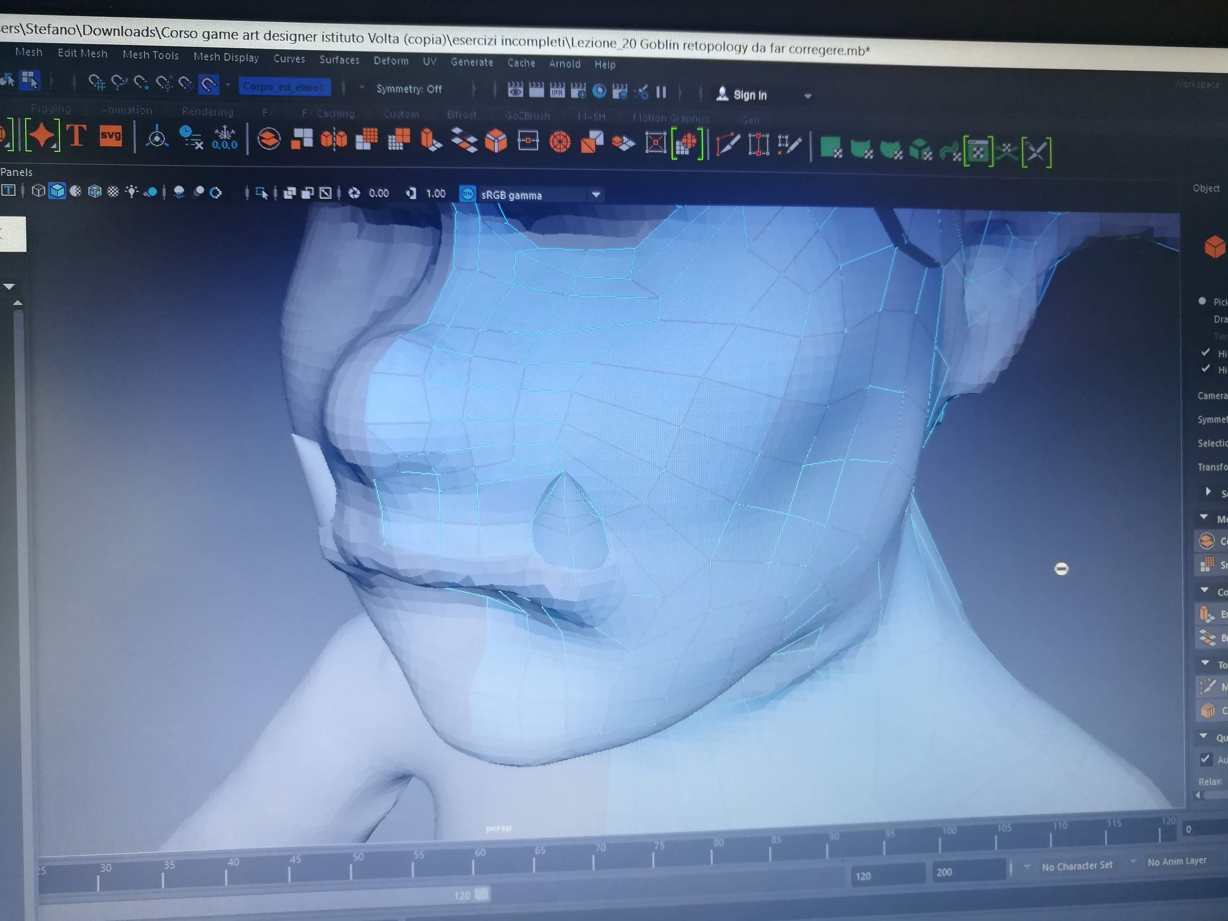

Hi I'm having a problem with Maya's quad draw that you can't see well. Instead of being like Figure 1 we see it as Figure 2. How can I solve the problem? I contacted Acer support, my pc's brand, and they told me to contact you.

 Even if I have modified something it is never like figure 1. I would like just like figure 1 (black borders and that net color). In my case there are no black borders and the polygons are seen in transparency

I am having the same exact problem in Maya 2018.  Did you ever find  solution?

If I remember well, I uninstalled and reinstalled because it was an issue of drivers. Let me know.

Extremely late, I know. But just in case.
The reason why Quad Draw's light blue instead of dark blue is a different rendering engine.
Go to Windows > Settings/Preferences > Preferences > Display > Viewport 2.0
and change it from Legacy (Could be OpenGL Legacy) to DirectX (Could be DirectX 11)
This should solve the issue.
