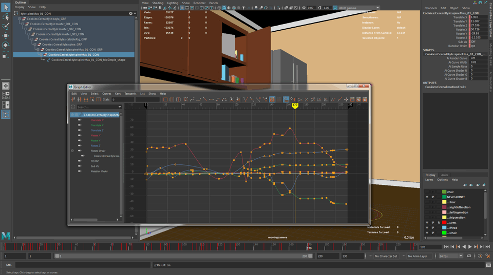

Long story short some control have lost their key frames in the timeline as well as channels in the graph editor. However, the animation still plays! The issue is I cannot change the location of the key via the timeline or the graph editor because it's as if they have vanished. Any solutions? I've attached a image as reference. mayaeditorissues.png

Alright so the "Kyle:spineMas_01_CON" node is animated but the keys are missing therefore I can't make changes to the values.

@Anonymous . I looked again at your first screenshot.
You did not select the transform node, you selected the shape node, then of course you will not see any keys.
You have to select "Cookies:Cereal:Kyle:spineMas_01_CON", not "Cookies:Cereal:Kyle:spineMas_01_CON_hipSimple_shape"

Hello!!
Is there another way to select the control? Because every time I click on the shape it pulls up the "Cookies:Cereal:Kyle:spineMas_01_CON_hipSimple_shape" I can't seem to find it on the list of controls either on the left hand side of the screen in the tree view.

OH MY GOSH THIS WORKED!!!!!!! THANK YOU SO MUCH I OWE YOU MY ENTIRE LIFE Smiley Happy

mspeer
Hi!
A) Display Layer ...:controls, disable "T", or
B) also use Drawing Overrides -> Enable Override as for the shape node
So it's all there but simply not selectable (at least from Viewport).
