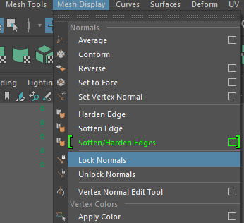

When I use the grab brush in the sculpting tools, the geometry starts to artifact (only within brush regions).
If the vertices haven't been modified, the artifact doesn't show.  Once I toggle the smoothing operation or go out of sculpting mode, the mesh goes back to normal.

Hi @jicdesigns
locking the normals will fix it .after you are done with grab tool you can unlock the normals.
as @mspeer  said it is a bug in this release "2020 to 2020.2"  you can report it as a bug in order to they fix it in the next release.

zewt
That's a known bug in 2020, I reported it a while back.  Surprised it hasn't been fixed yet, it's really annoying.  It's not related to locking or unlocking normals, it's just a bug with the sculping tool.  It's a viewport bug only, the underlying mesh is fine.
The only workaround I know is to enable mesh smoothing (3), but that doesn't help if you need smoothing off or if sculpting with smoothing enabled is too slow on the mesh.
