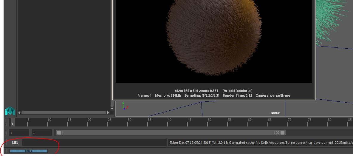

I am new to Maya from Softimage ... ouch.
Anyway ... I am having an issue where the cursor will turn into a WAIT hourglass cursor even though I can still click on menus and objects. It is stuck in the wait state.
Has anyone else experienced this ? Another artist here has the same exact problem.
Thanks !

Sometimes this can happen if you run a script that uses Maya's built-in progress bar.  If the script errors out and the progress bar never sets endProgress to True, then the cursor will keep spinning, and the progress bar will be stalled on the status bar.
Do you see a progress bar in the status bar of the main window?  (If not, I guess this is not the problem.)
in reply to: rflannery
as a matter of fact I do see a progress bar on the bottom left status bar. I am using Yeti/Arnold and after a render is when it seems to happen. The bar stays at 100% and cursor is an hourglass (or waiting circle).
Is there a workaround ?
M
in reply to: Anonymous
It seems Arnold is not closed after the render is done.
Does everything turn to normal, when you close the render view ?
If you're on windows open the task manager, I don't know if Arnold has a seperate process running, but if it does, you should see it in the task manager and in that case you could end the process manually.

I'm not familiar with Arnold or Yeti.  One thing you could try is to open the Script Sditor and see if there are any errors.  If there are, you may be able to figure out what the problem is and fix it.  For example, if it says file "C:/MyStuff/myfile.blah" is not writable, maybe you could ensure that file is writable or write to a different file.  Then when you do the render again, it should complete successfully, and the wait cursor should go away.

Hi, probably a process was started but could not complete properly. The best way to solve this is to close the opened Maya window and then delete the Maya preferences folder.
