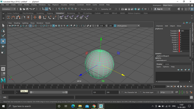

I've been trying to animate on Maya 2019. But as soon as I move away from a key frame, the values all get reset into zero. The key is there but without the values that I've given. I'll link a few pictures for reference

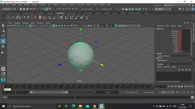

I tried to do the same thing with a simple sphere without controls, just to check if it was the rig's problem. But nope, it's the same result:
Before keyingBefore keying
Keyed and movedKeyed and movedScrubbing but values become zeroScrubbing but values become zeroBack to key that is now having no valuesBack to key that is now having no values
I also opened an already animated file of a friend to check. Only their animation works and key values are visible while any key I add just goes back to zero. I've gotten the software reinstalled twice and it happened in the 2018 version too. I have no idea what is going wrong. Please help!

Hi!
For me it looks as if you do it in the wrong order, first you create the key and then you change the values.
You need to set the values first and then key these values or you need to use Auto Key.
Thank you! No wonder everyone I asked were confused because nothing else was wrong!!
Thank you for replying but turns out I was doing it in the wrong order ^^" The graph editor was also showing nothing because of my mistake
