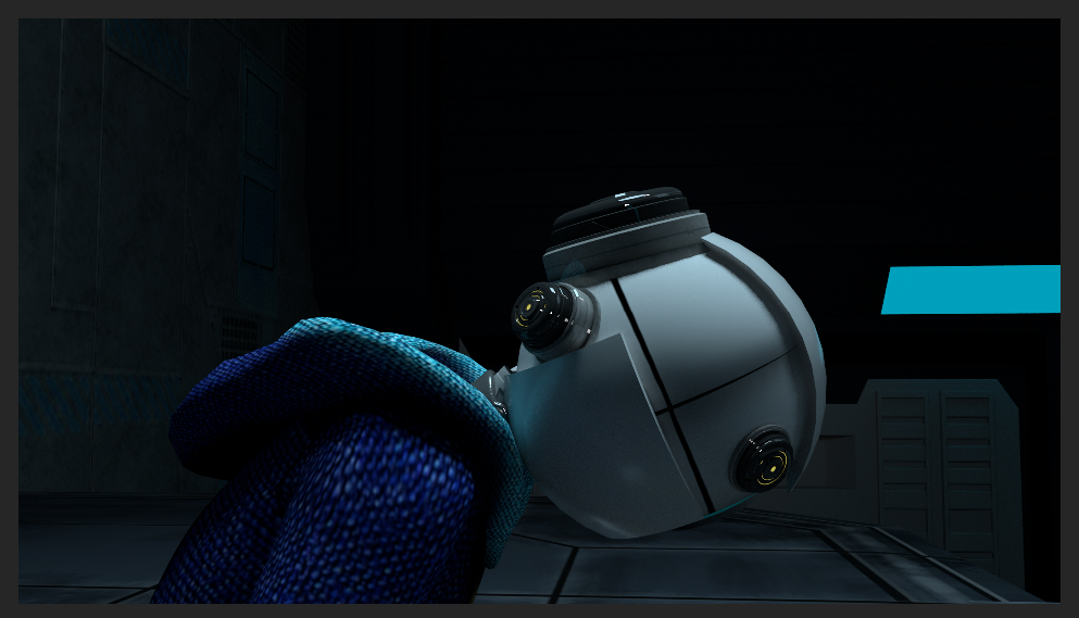

Hello. I recently find out that GPU rendering is way faster that using CPU.
However, when I compared both pictures rendered by CPU and GPU, this happened.
CPU rendered
GPU rendered
I thought both rendering works exactly the same, except using different calculation.
Should I try more denoising process? Or is my graphic broken?
I wish to know.
p.s. I'm using geforce RTX 2070 super

The sampling is different on GPU. There's no splitting, so you need higher AA
https://docs.arnoldrenderer.com/x/i4QsBQ
Matching Noise on CPU and GPU
Matching noise can take a little experimentation because Arnold GPU uses Camera (AA) sampling only. We recommend you also use Adaptive sampling. Here are some guidelines:
  • Set the Max. Camera (AA) in the range of 30 to 50 (depending on the scene, you might go closer to 100). In general, the max samples should be a large value. A large max samples means that the quality is controlled by the noise falling under the threshold, instead of by clamping to the max AA.
  • Set the Adaptive Threshold to something like 0.015 or 0.02. For a noise-free render, lower the threshold value, maybe even as far as 0.010.
  • Set the Camera (AA) samples to around 3 or 4. One of the few reasons to go higher with AA is for motion blur. The higher the number of Camera (AA) samples, the less of a speedup you'll get from adaptive sampling.

I tried maximum scale of both camera AA and max.AA
.....and it still has so many grains.....
Should I try something on actual cameras?
Is there any arnold control setup to remove grains in camera attribute editor?
I really wonder.
*due to uncertain process, I'm rendering my image as JPEG sequence.

Use only 4 samples for AA.
Up the samples in your lights to 2.
Lower the noise treshold.
