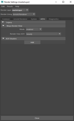

Hi guys,
I am new to Arnold, and it's a great render engine !
I have updated MtoA to 2.1.0.1 last week. all was working perfectly, and this morning, I cannot access my AOVs...
Any idea ?
Thanks guys !

Hi!
Try a reset of your preferences.
Rename the folder prefs in folder 2018 to something like prefs_backup, or to reset everything, the folder 2018 to 2018_backup (or even the maya folder to maya_backup). Maya creates new folders (don't copy preferences from previous Maya versions). Detailed at:
https://knowledge.autodesk.com/support/maya/troubleshooting/caas/sfdcarticles/sfdcarticles/Reset-May...

Thank you mspeer !
Problem solved 🙂
