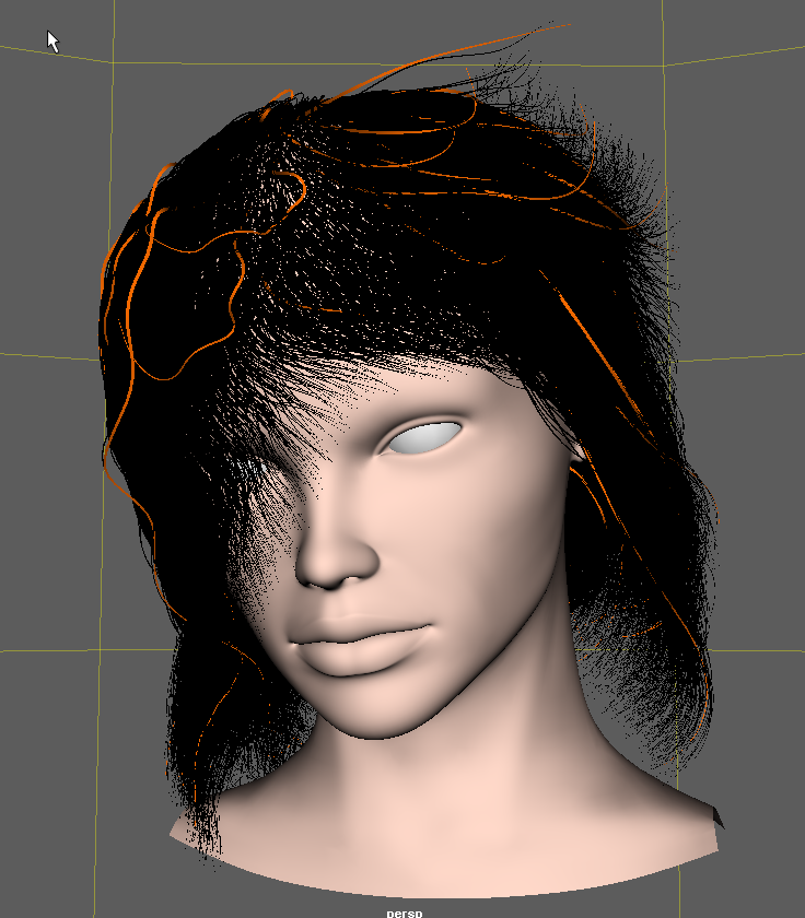

Hi, I have a problem
I created hair with XGen with guides and created hair system. But when I play the simulation, the xgen hair doens't collide with the mesh. I already put the Collision Modifier, exported the mesh in alembic's file and imported it in the modifier but is not working, even I put two Collision Modifier. And I make the mesh a passive collider.
Anyone know what's wrong?

Here is. I used Renderman.

I'm sorry, I was thinking in a solution that I send the wrong file.
Here is, the model is a head and have a collision modifier with the alembic file. I used Vray.

Michael_Todd
OK...
Several things to note
First, the scalp object has transforms on it and ideally the transforms should be frozen as XGen uses the untransformed object postions and scale as to generate a pref that forms the basis for determining density and other parameters. You should freeze the transforms on the scalp as having the scale on the object can mess up the guide placement (which seems to be happening in your scene)
You should delete your current guides and the xgen pref from the scalp geos shape node:
Freeze the transforms on the scalp and save the scene and reopen it to force xgen to regenerate the xgen pref in the correct space.
Make new guides from the hairsystem output curves:
Second, you have set a high spline segment count but a low modifier CV count. This should be the other way around
The one that needs to be high is the Modifier CV count as 5 cv's for collision is too low for the length of hair and the shape of the head. The Spline segment setting is effectively a subdivision of the modifier cv count and is more of a render setting than an evaluation setting.
Third, I'd recommend not parenting the scalp to the joint. In general this should be ok, but it might be better to simply shrinkwrap the scalp to the head as a deformer keeps the connections 'Dirty' in that Maya has to evaluate the changes every frame. You could make a copy of the scalp geo and keep that parented to the geo and use a blend shape to drive the geo xgen is bound to as well.
Having done this the collision results are much better:
Fourth, I'd recommend adding more guides and making a new hairsystem (delete the entire hairsystem, nucleus and any rigid bodies and remake them again after adding more guides.) This will improve collision fidelity between the guides and the mesh  and give you more control over the shape and interpolation. New guides will be interpolated between existing guides, so there's little need to reshape them after adding new ones,

I'm sorry, while I'm working with XGen I'm learning too. What do you mean with hair system output curves? Only I have to create curves and put them like Curves to Guide? And what is the VP, and the difference between 1 and 2?
By the other side, I made another file from zero, freeze the transform of the scalp, create curves, put them like guides in xgen, and everything work fine. But the density has to be 10, I don't know why but with 10 is a lot of hairs.
About the simulation, in the viewport I can see the collision but to make that sure I render, obviously, but doesn't appear. This time I use Renderman, I already set it, with the materiales of renderman. The collision is fine, I think, but no render 😕

The Output curves from the nHair system
Select the curves themselves, not the group then use the curves to guides utility in XGen to make guides from them.
The Density doesn't have to be 10. Density is calculated as the number of primitives (hairs) per unit area, which in XGen is always CM. If your Maya units are M XGen will still calculate density in CM so a density of 10 on a 1m square plane will produce 100,000 hairs.
Also, there are three density settings to consider, the generation Density on the Primitives Tab, the Preview Density and the Render Density on the Output tab
The Generation Density set how many primitives XGen will create on a given get of faces based on their surface area.
The Preview Density can be set to only draw a given percentage of those hairs in the Viewport
The Render Density will set the percentage of the generated hairs to send to the renderer.
When rendering with animation, you need to generate a cache for the XGen Patch, the geo that XGen is bound to:
if you are using simulation curves to drive the guide motion, you need to make an alembic cache of the curves and turn off live mode  in the Guide animation section and point to the curve cache:
