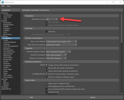

This probably isn't it, but considering nobody else is chiming in, I thought I'd at least give you something to try.
I remember a while back I had some weirdness that was fixed by switching my animation evaluation mode to "DG".
Message 3 of 8
maeyoshi
Thank you. I tried that, but it didn't solve the problem.
