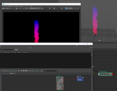

sepu6
Not even sure if Arnold support this old method, but if you render the maya hardware and apply the particleCloud default material or just add one like I did. i works without doing much.  But yeah I would do this in BF - faster and better. Anyhow is working here. M 2025.3
J-Fry
Ahhh!!!
That works!
Thanks so much, sepu6!
(I guess I thought the "(s/w)" next to the cloud type stood for "SoftWare" rendered.)
You're great!
