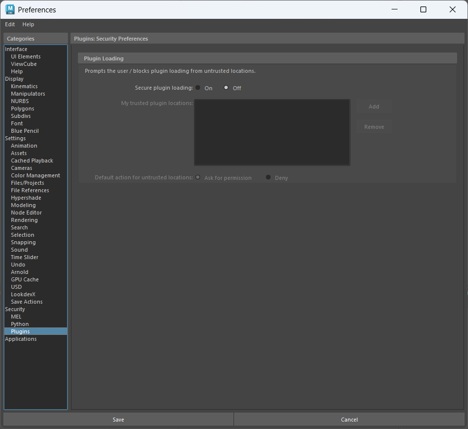

If the error affects loading your scene, you can disable secure plugins/Python/MEL in Preferences under Security.
You will receive a warning if you do this, so only do this if you trust the plugins you are trying to use.
Maya Security PreferencesMaya Security Preferences

not working (Maya 2025.3), even after adding the plugins-folder to the list of trusted plugin locations and restarting the program.
"Error: file: C:/Program Files/Autodesk/MayaCreative2025/scripts/others/pluginWin.mel line 316: File C:/Program Files/Autodesk/MayaCreative2025/bin/plug-ins/svgFileTranslator.py does not have a valid digital signature and is not authorized for use with this application"
