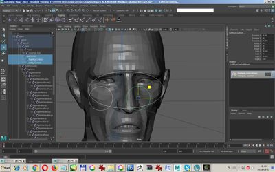

Hi. I have a problem with my eyes movement on a rigged mesh. I've set an aim constrain for each of my eyes, then parented it to the neck joint of my head. I also had to center pivot for my eyes, so they rotate in a right way. So far it seems to work well:
Przechwytywanie w trybie pełnoekranowym 2018-08-07 184426.jpgPrzechwytywanie w trybie pełnoekranowym 2018-08-07 184435.jpg
If I move my rigged neck, eyes seem to follow correctly:
The problem starts, when I try to rotate them after changing my head's position:
Przechwytywanie w trybie pełnoekranowym 2018-08-07 184448.jpgPrzechwytywanie w trybie pełnoekranowym 2018-08-07 184450.jpg
I've digged through lots of threads and tutorials, but haven't find any answer to solve my problem, and without correct eye movement I'm unable to proceed with my animation.
Please, help.

You need to have two joints at the center of the eyes, parented to the head joint.
Then you have to skin your eyes to those joints.
Then you need to aim constraint the eye joints to the individual eye controllers.
Cheers

Yes this is a common problem. First unbind the skincluster then parent the eyes with the head joint not neck joint and apply the skincluster also apply the aim constraints to the eyes. Still if your problem is not resolved please upload your scene file here.
