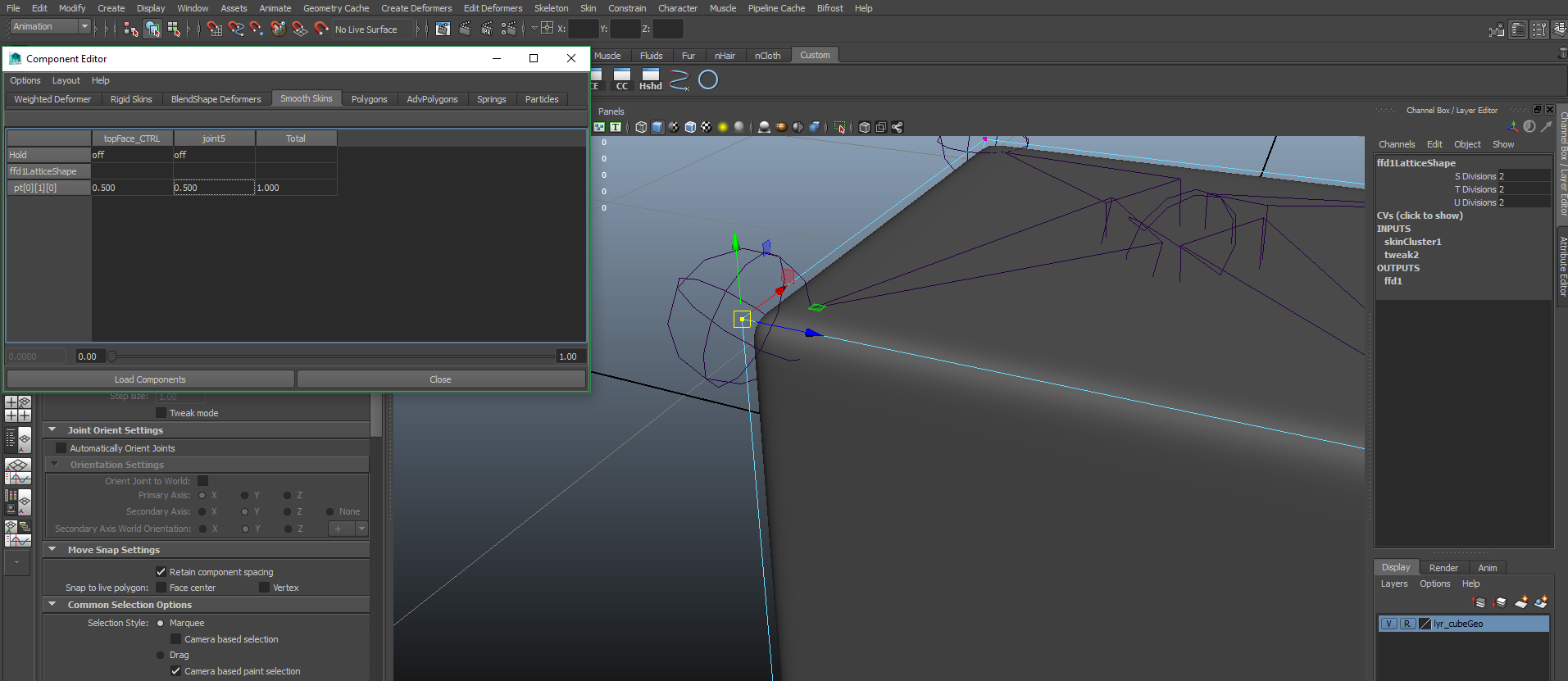

Hi Mathias. I'm trying the joint method that you used, but I'm running across a weighting problem. Do I need that second lattice to be able to control the corners like this? Right now, the movement of the corner control isn't 1:1 with the lattice vertex (well, it's 1 : 0.5 to be exact).

The problem you're running into with the skinning is that you added your control object as well. Only select the joints and you should be fine.
- Mathias
