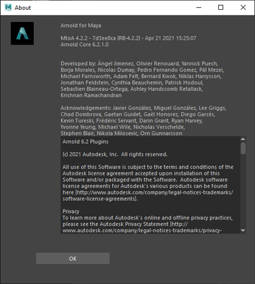

Latest version of Arnold for maya 2020 is installed by downloading it from autodesk website and installing it.
I use maya 2020.4
