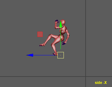

I need to parent a bone to a skeleton in an animation like this:
Captura-de-pantalla-2022-05-24-133655
But when I parent them both, the skeleton position becames relative to the bone, instead to world space, like this:
Captura-de-pantalla-2022-05-24-133731
Is there any way for parent them and keeping the world position of the animations?

Hi Mspeer. Thanks for your help.
When I use the preserve position option, It parents the objects in the way I want, as you said. But when I change the frame, It goes to the wrong position again (relative to the parent, instead of world space)
As an example:
Captura-de-pantalla-2022-05-29-205920
- I want to parent this rig to this joint.
Captura-de-pantalla-2022-05-29-205949
- When I use the "preserve position" everything goes as desired.
Captura-de-pantalla-2022-05-29-210006
- But when I go to the next frame of the animation, the rig changes Its position relative to the joint, instead of preserving Its position.
Any help? I'm pretty sure this can be easily done, but I cant figure out how.
Thanks!!

@Kahylan Sure! I'm trying to add a Root Motion bone to the animation. This extra bone is used in videogame engines (Unreal in my case) to drive the collision capsule along the animation path.

That was what I would have guessed, I'm just a bit confused why the Root Motion Joint isn't at the world origin (0,0,0) where RMJs normally are located, because in that case it would not cause this problem.
There are two easy ways to achieve what you want in Maya, but I'm not quite sure with both how well they will translate to Unreal.
The first one is to turn off "inherits Transfrom"  in the Attribute Editor on the joint you are parenting to your RMJ before you parent it. This will cause the joints matrix to completely ignore the RMJ, so it also won't move when the RMJ is moved.
The second one is to offset the Parent Offset Matrix, this solution only works in maya 2020+, the offset parent Matrix options are located right under the "inhertit Transform" option in the Attribute editor. You can Simply take your RMJs  translate values multiply them by -1 and put that value in the corresponding box in the composition Tab this will only work if the RMJ only has Translation, not with Rotation or Scale. This option will also allow you to move the entire rig by the RMJ if you wish to do so.
There is a method that is a bit more complex but I think the chances with this one to transfer correctly to unreal are better then the other two above. Offsetting animation. Once you have parented your rig to the new joint, you just offset back the entire animation curves on the joint right beneath your RMJ relative to the parents offset to world the origin.

Thanks for the help. Finally I managed It by doing a script (basically, using locators to save the transform for each keyframe, and apply It once parented)
