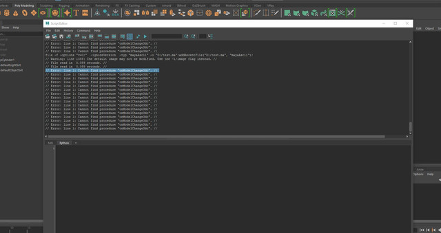

I noticed whenever I open brand new empty scene, Maya insert the same error into that scene
Capture

Yeah that script is not working. As mentioned before, it sometimes causes the viewport not refreshing. The second script is not working for me either. Have you tried the script I posted? For me it works if I run that and save the file (otherwise the "infection" will remain on the scene file if you open it later). Also works for a new/blank Maya session that gets infected.
If you want to clear the onModelChange3dc infection manually, either delete this line on each of your infected .ma file with text editor:
-editorChanged \"onModelChange3dc\"
or you could try preventing the infected uiConfigurationScriptNode to load on new Maya session.

Thanks, that works. Tho I had to clean my userprefs file from "editorchanged ... onmodelchange ...." lines first. Cheers!
Message 20 of 28
this is still not working... i tried all of all scripts posted.. darn...
