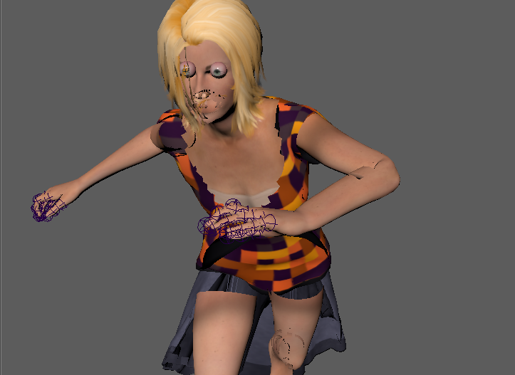

When I send my character created in Adobe CC Fuse to Mixamo and Autorig it there and open the model in MAYA I have this problem as I've shown in the picture below. I really have to solve this.model.png

It's hard to tell from that screenshot what's wrong.
1. Check scene-scale and Camera Clipping Planes.
So when I dont use textured button(red circled one) the mesh is OK. But when I press it and the textures come, they are all into each other and transparent. That is my problem.

Hi!
It could also be a problem with normals and/or used Transparency Algorithm +
Transparency values on materials, check if they are really 0.
For further help please upload a scene-file (and at least 1 texture, you can cut down the scene as long as it shows the problem)
I'm sending you the model and its texture files (rar file). Just put it in maya scene, activate Textured button (red circle in the previous picture) and see what you can do pal. Looking forward to solve the problem ASAP.

Hi!
As i said before it's:
Transparency Algorithm + Transparency values on materials.
So change Transparency Algorithm of Viewport or remove Transparency from materials.
Oh, it was the "depth peeling" setting that solved it for now 😄 Thanks for your guide sir.
