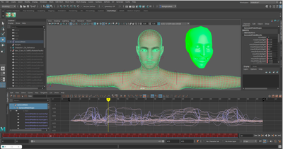

I've been trying to solve this by myself for 3 days and now I know I won't make it alone. First of all, here is my workflow :
- I record a mocap face animation via Rokoko studio
- I import it in Maya
- I import a genesis 8 character from DAZ too (with the official bridge)
- I copy the rokoko face blend shapes
- I paste them in the DAZ blend shapes
As you can see below, values are really copied but the genesis face remains still (unlike the rokoko one, smiling here).
Please note when I import from DAZ a genesis 8 with the default morphs (ie LipTopOutIn instead of the standard mouthRollUpper), it works after having renaming some of them BUT there are still incompatible with the standards.

OK, when I try to change the morphs values manually, it shows  this :
 Error: line 1: setAttr: The attribute 'Genesis8_1MaleBlends.mouthSmileRight' is locked or connected and cannot be modified.
How to unlock or disconnect an attribute ?

Ideally, the target blendshapes should be named and ordered in the same order as in Rokoko's face, matching in numbers. Then you'd be able to copy-paste them with ease, as in youtube video. Otherwise you'd copy in ordered portions or use a script.
Rokoko's face, depending on what version you use, might not match ARKit blendshapes - flipped and missing targets. Then they sent a fixed version, I suppose it should be included in the latest Studio.
Regarding the error message - it isn't obvious from your screenshot - we see just part of the targets.
As to being locked, it shouldn't be colored - here it seems you have some existing animation. Select all the channels and RMB > CutSelected , scroll through to ensure those are really free. For other kinds of locking you might use RMB > UnlockSeleted or BreakConnection.
Now, it should be safe to copy anim curves from Rokoko to Genesis8.

The copy/paste work. The blendshapes value are the same between rokoko and genesis BUT it won't be animated. As you can see in this pic, the genesis face is still despite all the morphs data (should be smiling like the rokoko face).

Idk why, perhaps because of the version mismatch, the deformers (blendshapes and skin clusters) in your scene doesn't seem to work, even the influences are there. Even Rokoko's face is still. However, if I create a new blendshape, then it works. Were those deformations working in your Maya? What version?
Regarding the copying the blendshapes - those are really locked because you have this Morphs group, which has all the connections to the Genesis blendshapes.
Which basically means that you should paste the animation to there. I couldn't check how it is working, because no deformation there.

The thing is, you should check if Genesis blendshapes are functioning - deforming the face. E.g. try setting Morphs.jawOpen to 1.ooo. If mouth opens, then you are good to go with pasting.
And, I wouldn't use the GraphEditor to paste the curves, as it is rather easier to select those animations in the ChannelBox and use RMB > CopySelection, then select the Morphs, and select the channels again and RMB>PasteSelection (ensure the animation starting frames match). Sequentially, the GraphEditor will show animation curves in both.

Exactly what you say right after :  "try setting Morphs.jawOpen to 1.ooo. If mouth opens, then you are good to go with pasting."
The jaw didn't open. The deformations work only on the rokoko face.
