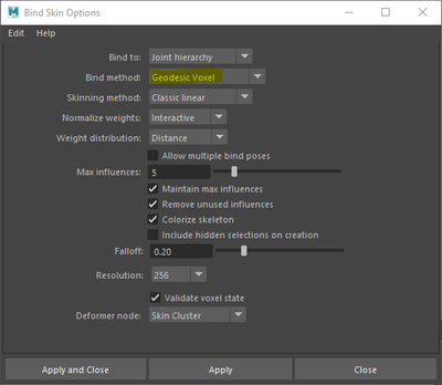

I had to select the joints and planks that I wanted to bind and then choose this combination of options in Bind Skin tool:
Now each and every plank has a joint binded to it:
stephenkmann
you could also just set max influences to 1 on closest
