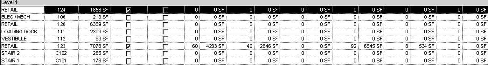

Hi @mstein7484 thanks for your help. My model indeed worked in Rvt 2017 for the LEED v4 opt 1.
However, I would like to ask you one more question regarding my 2016 model for LEED v4 opt2. My 'room 124' it is not being analyzed by the plug-in. I already checked its room properties and materials and it looks like all the other rooms in the model. When I go to the schedule it does not show any information about that room.
See attached photo:
Any thoughts?

Message 10 of 10
mstein7484
in reply to: Anonymous
Hi @Anonymous
There could be any number of things causing the results to be missing for the room. Refer to the first posting in this forum, which has documentation for LAR (Lighting Analysis for Revit) and make sure you are following all of the steps to prepare your model properly.
