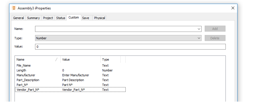

arkelec
Thanks for your reply DRoam.
I'm getting some errors though - what am I doing wrong?
I told you my VBA skills were weak Smiley Sad

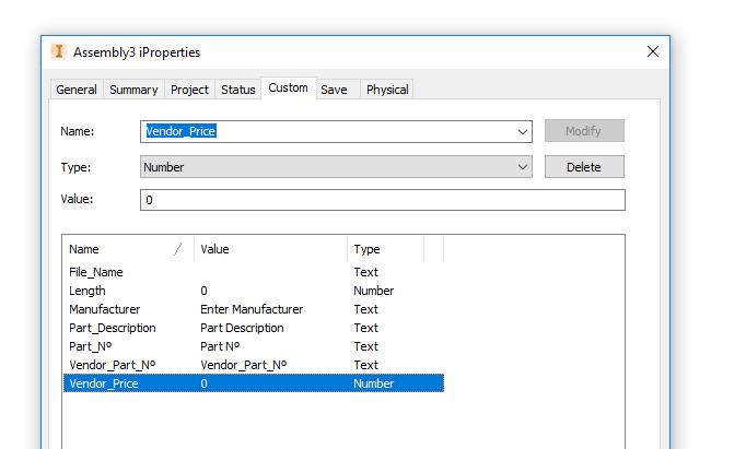

1 more question if I may.
The iProp fields are currently formatted as text. I want to add a Price field. Am I better to use text, or can I format this field as currency (or another number format)?
Message 9 of 19
DRoam
Great!
Good question, I guess it depends on what you're using it for. The possible iProperty types are: Text, Number, Yes/No, and Date, so out of those your options would be text and number.
If it's purely for displaying on drawings or something, you could make it text so you can make it look nice, like "$1,499.99". But if it could be used for calculations or something, you'd be better off storing it as a number.
Unlike Parameters, iProperties are versatile and can be freely switched between the various types. So if you set an iProperty to a number via iLogic, it should convert it to a numeric iProperty. And likewise for text (string), yes/no (boolean) and date.

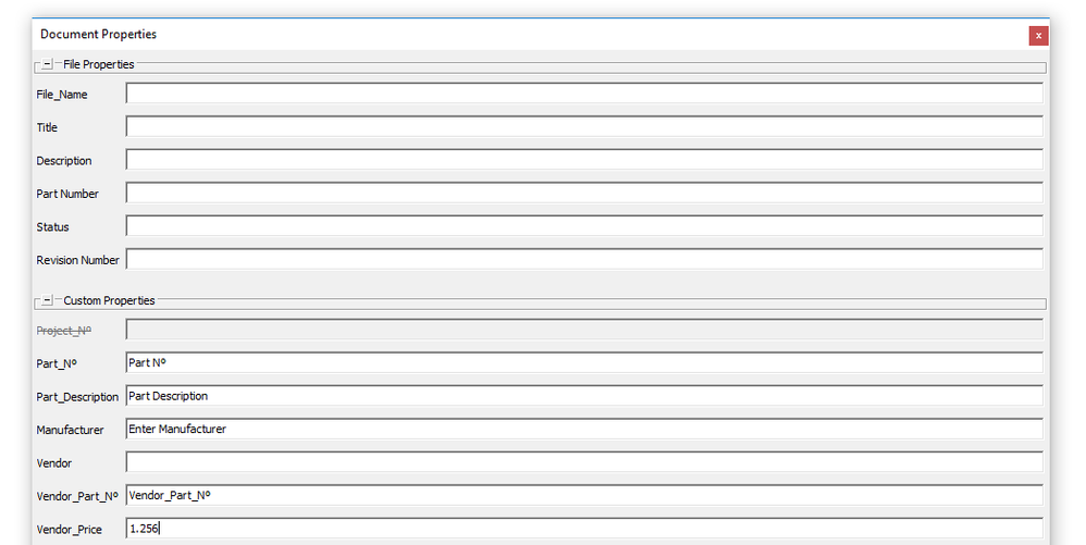

I changed the declaration for Vendor_Price as follows:
Dim Vendor_Price As Integer = iPropGetInt("Vendor_Price", 0.00)
All seemed OK, but then a message box with "!Conversion from string "Vendor_Price" to type 'Integer' is not valid."
What have I missed?

Hi DRoam, sorry that this is dragging on, but an issue still persists.
If I add anything to 2 decimal places, the filed is converted to text.
I have no idea.
This is the code:
Dim Vendor_Price As Double = iPropGetStr("Vendor_Price", 0.0000)
I want the price format to be up to 4 decimal places.
To test this, I make sure that there is no custom iProp called Vendor_Price.
After running the rule, the form I have created is loaded:
The format is to 1 decimal place, but still a number:
So I load the custom form & add a price:
But when I check the custom iProp, it's now text:
What am I doing wrong?

No problem, iProperty data types can be finicky.
I'm pretty sure I know what's going on. The culprit is most likely the input form. Forms will always set iProperties to the data type they had when they were added to the form originally. So my guess is, when that form was created, the "Vendor_Price" iProperty was in the Text format. So now, even though the iLogic has created it in the Number format, as soon as you change it using the form, the form is converting it to the Text format.
The fix for this is simple -- just delete Vendor_Price from your form, then make sure the iProperty exists in the current document as a number, and then re-add it to the form. Then, whenever you edit Vendor_Price using the form, the form will always set it as a number rather than as text.
Let me know if that works for you.
Message 17 of 19
arkelec
Hi, thanks, yes that seems to work.  I did wonder about the form myself, but couldn't see anywhere for the format.

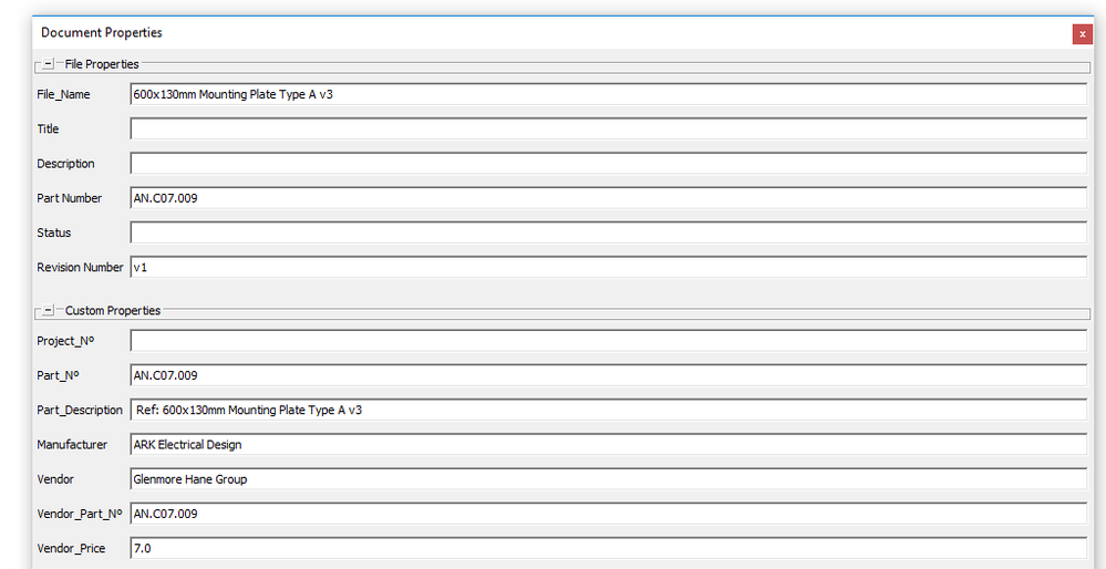

However...is there a way of displaying zero's trailing the decimal point to 4 figures?  Or even 2?
Message 18 of 19
DRoam
Yeah, it would be nice if the form editor would tell you which format the iProperty field is using.
And unfortunately, no, I don't think there's a way to do any kind of format control using the form. If you really need a formatted iProperty, your best bet would probably be to create rule like this, that will format a secondary dedicated text property for the price, based on the numeric iProperty's value:
Dim Price_Num As Double = iPropGet("Vendor_Price",0.00)
Dim DesiredText As String = "$" & Price_Num.ToString("0.0000")
Dim CurrentText As String = iPropGet("Vendor_Price_Formatted","")
If Not CurrentText = DesiredText Then iProperties.Value("Custom","Vendor_Price_Formatted") = DesiredText
Make that an External rule so you can add to or modify it if needed, and add it to the "iProperty Change" event trigger so it'll always keep the formatted version updated with the numeric version.
Then you can add the formatted version to your form, and make it read-only, so you can easily verify that it's correct:
It should always update whenever the Vendor_Price iProperty is changed. I try to avoid stacking iLogic onto keeping iProperties up to date like this, but sometimes it's unavoidable.
