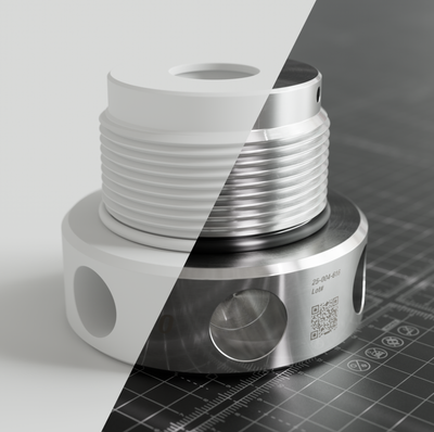

Message 7 of 15
chris
@Michael.Navara can you change your above code to include the current view of the part. For example, I have mine set to a "Front" View zoomed into a specific distance to fill the screen, can I make it save that? Or better yet, could it be set to save out all 6 cube views? (top, bottom, left, right, front, back)?
Message 8 of 15
ejaL9K8H
Hi
We are trying to make a automated sales document directly from a Factory layout into a Word document, and we would like to show the thumbnail in this sales document.
Message 9 of 15
chris
Renders look so much better. Our old catalogs used CAD views, once I was hired our catalog images went to this, still using the CAD data. If you guys would like to see what your CAD would look like rendered, just PM me

Message 11 of 15
ejaL9K8H
Hi Chris
Renders looks amazing!
But aren't renders a time-consuming process? It will be too computer demanding if I have to make renders of 50-200 parts in a assemply?

Message 15 of 15
chris
@ejaL9K8H  They can be, I rendered out almost 1000 parts and all the large Pump skid assemblies, it took some time, but I leveraged all the CAD models I created. It's mainly a quality issue. Plus you can create "models" that can be rotated on the webpage. IMO, it's just better and cheaper than hiring a photographer or buying everything needed to take product photos, which I do as well, but I'd rather just get or make the model and render it
