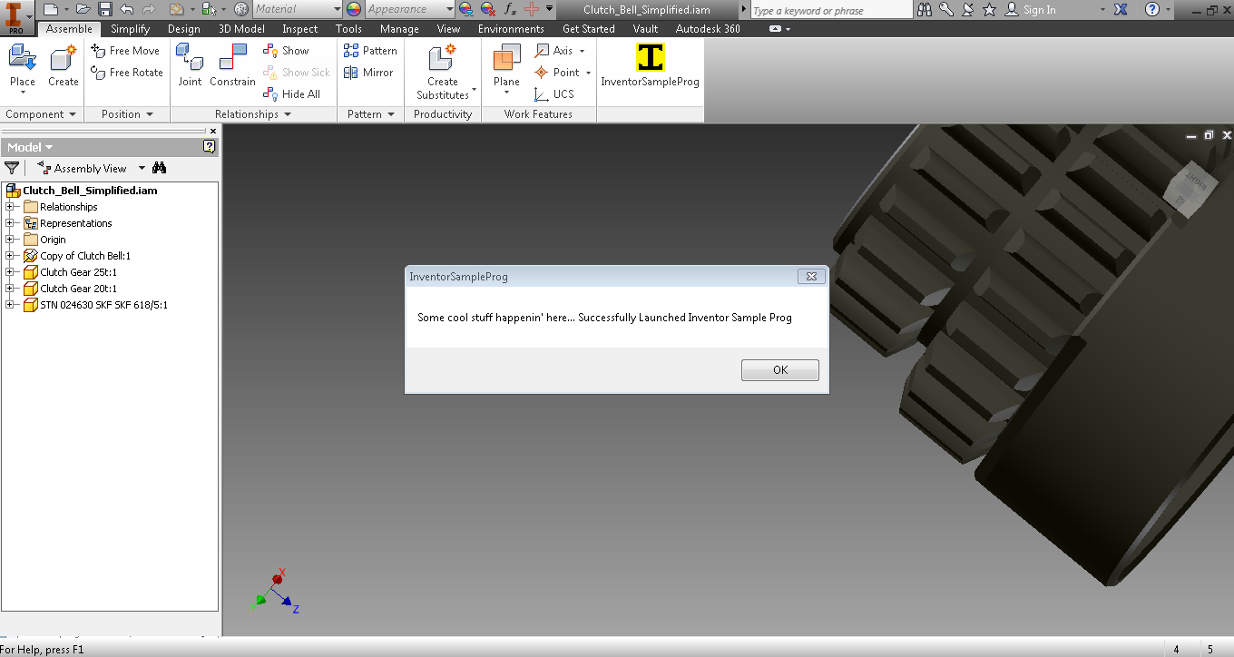

The Sample Invetor Add in program worked.
The attached zip file contains a working Inventor Add-in sample program. I have also attached a image showing that the InventorSampleProg worked successfully. I changed the Message from
    Some cool stuff happenin' here...
to
    Some cool stuff happenin' here... Successfully Launched Inventor Sample Prog

12) Launched Inventor 2014 Pro
13) Opened an assembly and in the Assemble Tab, saw the InventorSampleProg button with "I" ICON.
14) Clicked on the  InventorSampleProg button and got the message " Some cool stuff happenin' here... ". Then modified the message, and repeated the process and successfully saw the updated message.
