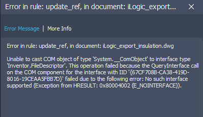

I have a code which you run within an assembly that makes a copy of the assembly(saveAs) and puts it into a predefined drawing sheet setup. The assembly and parts are all correctly referencing the new(copied) instances, since my code also copies parts.
however it doesn't replace the object reference for my individual part drawings, which means if i generate more than one drawing, they will start interacting with each other since the drawing references the same part file (the original ones)
Imports System.Windows.Forms
Imports Inventor
Sub Main
Dim partpath As String = ThisDrawing.ModelDocument.ComponentDefinition.Parameters.Item("Location").Value
Dim pLoc = parameter("PartLocation") = partpath & "\3D\"
sheet1
sheet2
End Sub
Sub sheet1
Dim doc = ThisDoc.Document
ActiveSheet = ThisDrawing.Sheet("Sheet1:1")
End Sub
Dim oFD As FileDescriptor
Sub sheet2
ActiveSheet = ThisDrawing.Sheet("sheet1:2")
Dim viewModelDoc As String = pLoc & "Cloth.ipt"
oFD = doc.ReferencedDocumentDescriptors(1).ReferencedDocument
doc.ReplaceReference(viewModelDoc)
doc.Update()
End Sub
I have written this code within the drawing file(.dwg) which i thought would replace the reference, but i can't seem to get it to work.
my thought process was to make a sub for each specific sheet, then as the first action it will open up that sheet to get the active sheet model, replace the reference and then go to the next sheet sub.
the folder  \3D\ is an automatically generated folder from the initial assembly, which has both part files and assembly files within. every time a new version of the original assembly is generated, it will create this folder at the selected director. it will also create one called \2D\, however this is for the .dwg and PDF file.
the path could look like this
c:\[PATH to selected folder]\(new folder created with drawing number name)\2D and 3D lies here\
This is the error i'm getting when running the code, the problem lies around Line 27/28, but i can't seem to figure out what im doing wrong.

WCrihfield
Hi @op_thorsager.  There is so much here that seems wrong or questionable, I don't even know where to start.  In the first part of your code you are attempting to access two different Parameters, one named "Location", and one named "PartLocation".  You appear to be getting the initial 'path' information from the one named "Location", but then the next line of code is confusing me.  Are you attempting to set the value of 'pLoc' from the parameter named "PartLocation" or are you trying to set the value of the parameter named "PartLocation"?  You should not have two equals signs (=) in the same line of code.  What is your intent with that line of code?  Should the 'pLoc' variable be getting its value from the parameter named "Location" or from the parameter named "PartLocation"?  Do you need to set the value of the parameter named "PartLocation" to the same value as the 'pLoc' variable?
Your 'pLoc' variable is not 'shared', like your 'oFD' variable is, therefore, when you are trying to use it within your 'sheet2' Sub routine, it is not only undefined, it also does not have a value yet (as far as that sub routine knows).
In your 'sheet2' sub routine, you are trying to set your 'oFD' variable's value to a Document type object (ReferencedDocument), instead of a FileDescriptor, therefore it is throwing an error.  Then on the very next line of code, you are trying to use your 'doc' variable, instead of the 'oFD' variable with the 'ReplaceReference' method, which is only available to the FileDescriptor Type object, so that too would throw an error.
If the active drawing document has more than one referenced model document, then you may need to loop through each DrawingView on each sheet of the drawing, to replace the referenced model of each view, instead of trying to replace just the first file reference of the entire drawing.  Otherwise you may need to loop through each referenced document in the drawing documents referenced documents collection, instead of just its first one (if more than one).
I also attempted to correct the line of code stetting the active sheet of the drawing, but I am not sure what your intent was in having an entire sub routine just for activating a specific sheet of the drawing.
Below is a version of your code which I attempted to correct, with my limited understanding of your intents, and before getting the above questions answered yet.

This code only works if the original drawing file/template is located in the same folder as the original assembly(see image)
the code closes down the original assembly without saving to prevent the user from accidentally breaking the initial build. then opens up a DWG with all the sheets and so on, and a new assembly which is located within \3D\ together with the parts.
once the new drawing file is opened, the references will look like this (in this case i selected \temp\303030-2480\ as folder name and save path)
however since there are multiple sheets within this drawing document, where only a single part is present, then there will be more than just one model reference within the drawing document.
The idea is to have an event trigger which launches a rule that will replace the parts still referencing the original part files with the part files saved in the same folder as the assembly, however i will have to get the code working before setting up the trigger, just to prevent messing things up in the initial build.
If we take "cloth.ipt" for example, will this be oFile.ReferencedFileDescriptors.item(2) or how does this work exactly?
im still very new to this, and have been trying to learn the ins-n-outs of iLogic for the past month, and since i don't have anyone to teach me this, i will have to learn by trial and error/looking through forumposts/watching webinars on youtube :slightly_smiling_face:
p.s.: @raith-mb when you say "during the copy of your IAM", are you talking about doing the count within the code i posted a bit further up in this reply?
WCrihfield
Wow.  That is a rather long, and complex code for someone who is just getting started with iLogic, so I am impressed that it is working this well for you so far.  After seeing the whole (or most of) the code you are working with, I can see how attempting to implement our suggestions into it can seem more complicated than I had in mind.  Now I am thinking that I would suggest making a few different changes in a few different places.  I can see now that you do not yet have a 'list' of old & new full file names, as we were suggesting, so I am thinking about ways to create one within your existing code to help with replacing the drawing file references.
Between your Sub named "CopyDrawing" and the next Sub named "Export", you are declaring several variables.  Those variables will be 'shared' because they are being declared between any other routines, and not within any other routine.  When done that way, all other routines will recognize them, and be able to use them.
In that same area, I'm thinking we could create something like a NameValueMap or a Dictionary(Of String, String) type variable.  Those types of variables can store a list of entries, but unlike a normal/simple list or array, the entries in these each have two parts.  In a NameValueMap, you an unlimited number of entries, each pair having a 'Name' and a 'Value'.  Similarly in a Dictionary(Of String, String), you have an unlimited number of entries, each having a 'Key', and a 'Value'.  Using one of these, we could record the 'old' full file name as the 'Name' or 'Key', then the 'new' full file name as the 'Value' in each entry, at some point earlier in your code, like in your Sub named "CopyParts".  Then down within your Sub named "CopyDrawing", we could use that collection variable when we loop through each file reference of the drawing.  Instead of just getting 'Item(1)' of the drawing's ReferencedFileDescriptors, we would loop through each FileDescriptor In FileDescriptorsEnumerator (what you get from File.ReferencedFileDescriptors).  Then within that loop (For Each Object In Collection...do something...Next), we would check if the FileDescriptor's FullFileName matches any of the 'old' ones in our list, and if to, use its ReplaceReference method to replace the 'old' one with the 'new' one.  Does that make sense to you?  I know, it is a lot to take in, because this is a big, complex task you are taking on.
Wesley Crihfield
(Not an Autodesk Employee)
op_thorsager
I am just getting off work in a few mins, so will have to read about the use of NameValueMap, the posted rule is shortened by about 180 lines, but these were mostly just subroutines doing the same thing as the CopyParts sub, but with a few different components(mostly to skip the supressed components if any), this tool is the only thing i've been working on the past month, and currently sitting at about 750lines split into multiple rules, which luckily all works as intended, so i don't have to mess around in them. The only one i just cant get to work is the model reference updater, i found a few ones on different forums, but they all use a file dialog, but since i already have the path where the new components are, then i feel like its a waste of time to have the user run through each component via a file dialog haha
Thanks alot for the help so far, but i don't have more time today to try and wrap this up (fixed hours employed), so i'll get back to you tomorrow :slightly_smiling_face:
op_thorsager
I was thinking a bit about the issue, and since the initial parts are the actual part files on the sheet, which doesn't have the updated assembly reference.
this means it will be hard for the API to know which component i'm pointing at.
my thought was that i could have a rule called "replace" within each part file.
then have the assembly write to a parameter within the part file, which states the location of the "3D" folder.
once the parameter is set, then have the assembly do a runrule within the part, which then does all the copying/ replacing. I don't know if this would work though. I already have all the parts copied to the "3D" folder, its just a matter of getting the reference within the actual drawing(.dwg) to update the reference to the part files which are already copied.
idk if this would work, but thought i'd ask real quick, since it gets a bit complicated for me when it reaches this level
Another way could also look like this:
Have only the sheet showing the assembly file, the rest of the sheets will be deleted.
then just have a rule which looks at the path for the newly created individual parts, create a sheet and place the part in the sheet, loop through all the parts in the assembly save location, and for each part it will create a sheet where it adds the necessary views, this way i won't even be needing to update the other model references
