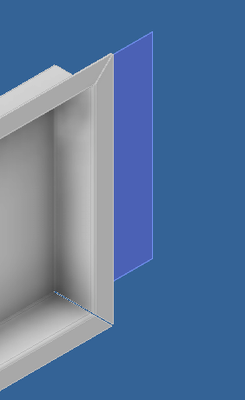

Hello Forum,
I have a hard time getting the following.
I have a script that automates creating plates with flanges
Problem: Some flanges that are angled +- 10 degrees from the orientation of the XY Plane (Ground plane)
Need to get the angle of the ground plane. For visual aestetics, but also dirt and such.
So before the flange is created, I want to make a "plane". So I can measure the angle from this plane to the ground plane. and adjust my angle before the flange is created.
The plane should be from the front face of the plate, angled from the top edge, then angled (90 deg for example)
But I have a hard time with transient geometry / transientBRepp / Client Graphics
I think i need to create this using transientgeometry.createplane
For debugging i want this visual with client graphics
Any help/example is greatly appreciated

Cadkunde.nl
I tried the workplane rotate around edge.
I think it was workplanes.addbylineplaneandangle
But the workplane creation keeps giving me an error when using input edge and face rather than axis and workplane.
Tried transient geometry plane but i mess up with the inputs as well, keeps crashing.
Ideal would be if i could get a temporary face with maybe brep somehow.
Because I have a good code to get the real angle between 2 faces (not shortest angle between 2 infinite workplanes)
Im kinda frustrated on the failed attempts :slightly_smiling_face:
The goal is to have a plane to measure with groundplane XY. And adjust the angle of the flange i want create next. Ideally visible for debugging.

JelteDeJong
This example creates a (very thin) box and aligns it with an edge that you selected.
Public Sub Main()
    Dim oTg = ThisApplication.TransientGeometry
    Dim edge As Edge = ThisApplication.CommandManager.Pick(SelectionFilterEnum.kPartEdgeFilter, "Select an edge.")
    Dim line As LineSegment = edge.Geometry
    Dim startPoint = line.StartPoint
    Dim translationVector = oTg.CreateVector(startPoint.X, startPoint.Y, startPoint.Z)
    Dim vector1 = oTg.CreateVector(0, 0, 1)
    Dim vector2 = line.Direction.AsVector()
    Dim matrix As Matrix = oTg.CreateMatrix()
    matrix.SetToRotateTo(vector1, vector2)
    matrix.SetTranslation(translationVector)
    Dim partDoc As PartDocument = ThisDoc.Document
    Dim transBRep As TransientBRep = ThisApplication.TransientBRep
    Dim transGeom As TransientGeometry = ThisApplication.TransientGeometry
    Dim boxMinPoint As Point = transGeom.CreatePoint(0, 0, 0)
    Dim boxMaxPoint As Point = transGeom.CreatePoint(10, 0.15, 50)
    Dim box As Box = transGeom.CreateBox()
    box.Extend(boxMinPoint)
    box.Extend(boxMaxPoint)
    Dim minBoxSurface As SurfaceBody = ThisApplication.TransientBRep.CreateSolidBlock(box)
    Dim cGraphics As ClientGraphics = CreateBox(partDoc, minBoxSurface, matrix)
    MsgBox("CHeck the preview")
    cGraphics.Delete()
End Sub
Private Function CreateBox(partDoc As Document, surface As Object, matrix As Matrix) As ClientGraphics
    Dim cGraphics As ClientGraphics = partDoc.ComponentDefinition.ClientGraphicsCollection.Add("OrientedRangeBox")
    Dim surfacesNode As GraphicsNode = cGraphics.AddNode(1)
    surfacesNode.Transformation = matrix
    Dim surfGraphics As SurfaceGraphics = surfacesNode.AddSurfaceGraphics(surface)
    Dim targetAppearance As Asset
    Try
        targetAppearance = partDoc.Assets.Item("Clear - Blue")
    Catch
        Dim sourceAppearance As Asset = ThisApplication.AssetLibraries.Item("314DE259-5443-4621-BFBD-1730C6CC9AE9").AppearanceAssets.Item("InvGen-001-1-2") ' "Clear - Blue"
        targetAppearance = sourceAppearance.CopyTo(partDoc)
    End Try
    surfacesNode.Appearance = targetAppearance
    ThisApplication.ActiveView.Update()
    Return cGraphics
End Function

Cadkunde.nl
Thanks for all the help, I will delve into this.
Cadkunde.nl
In my case I need Brep instead of client graphics. (for measuring, then deleting)
Also need to look better at vectors and matrix.
I worked with all kinds of things in the API, but this area gives me headaches, and avoided it a little until now.
Time to fully understand these components. I got good examples in both your replies to start thanks to you guys.
I think I'll manage from here.
Cadkunde.nl
With the examples I built the following:
I'm able to make a solid feature that I can angle much like a flange, and be able to measure.
Public Sub Main()
	Dim oCompDef As PartComponentDefinition = partDoc.ComponentDefinition
	Dim egdeLength As Double = ThisApplication.MeasureTools.GetMinimumDistance(edge.StartVertex, edge.StopVertex)
    Dim translationVector = transGeom.CreateVector(startPoint.X, startPoint.Y, startPoint.Z)
    Dim vector1 = transGeom.CreateVector(0, 0, 1)
    Dim matrix As Matrix = transGeom.CreateMatrix()
	Dim boxMaxPoint As Point = transGeom.CreatePoint(0.3, -10, egdeLength)
    Dim oBody As SurfaceBody = transBRep.CreateSolidBlock(box)
	transBRep.Transform(oBody, matrix)
	matrix.SetToRotation(90*PI/180, vector2, line.StartPoint)
	partDoc.ComponentDefinition.SetEndOfPartToTopOrBottom(True)
	Dim oBaseFeature As NonParametricBaseFeature = oCompDef.Features.NonParametricBaseFeatures.Add(oBody)
	partDoc.ComponentDefinition.SetEndOfPartToTopOrBottom(False)
End Sub
This is kinda what I wanted, but not sure if it is what I need.
Just need a 'face' in the position of the flange, before a flange is created, to measure it with workplane XY
I can measure the difference in angle in the direction of the flange.
If inventor measures an angle in the width direction of the flange, I can ignore it
If the angle of the flange is in +30deg/-30deg range of workplane XY, I should align the flange to be created with the workplane XY
Cadkunde.nl
Figured out that oBody.face(4) is what I need to measure angle
I dont need to create the feature at all (except maybe for debugging)
So this is perfect. Thanks all
