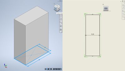

My requirement : Use the Inventor API to obtain a specific edge within a model feature and add dimension annotations to this edge in the engineering drawing.
1210550275
1210550275
The AddLinear method requires a GeometryIntent object created from the Sheet class, and Sheet.CreateGeometryIntent() can only accept edges within the view. How can I convert an edge in the model into an edge within the view?
Or, my approach might be incorrect. What are the correct steps to achieve my requirement?

This is a sample, how to create drawing dimension to the specified edge in model. It requires update, because it doesn't contain your logic for edge selection, text positioning, works only for part, etc. But it can be used as starting point.
Expected dataset:
  • Drawing with single drawing view on active sheet
  • Drawing view references simple part with one extrusion of box
'Get relevant documents
dim drw as DrawingDocument = ThisDoc.Document
dim part As PartDocument = drw.ReferencedDocuments(1)
'Get edge in model
' !! This is just a sample. Modify it for your needs. !!
Dim partEdge = part.ComponentDefinition.Features.ExtrudeFeatures(1).EndFaces(1).Edges(1)
'Get drawing sheet and view
Dim drwSheet as Sheet = drw.ActiveSheet
Dim drwView as DrawingView = drwSheet.DrawingViews(1)
'Get drawing curve which corresponds with model edge
Dim edgeCurves As DrawingCurvesEnumerator = drwView.DrawingCurves(partEdge)
If edgeCurves.Count = 0 Then
    Logger.Error("There is no drawing curve for specified edge.")
    return
End If
'Create geometry intent for edge
Dim partEdgeIntent As GeometryIntent = drwSheet.CreateGeometryIntent(edgeCurves(1))
'Crete dimension
Dim textOrigin As Point2d = drwView.Position
drwSheet.DrawingDimensions.GeneralDimensions.AddLinear(textOrigin, partEdgeIntent, DimensionType := DimensionTypeEnum.kAlignedDimensionType)
Dataset preview
1210550275
