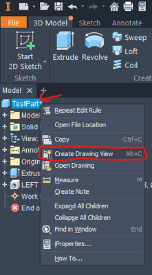

WCrihfield
Of course though, this simple manual process is just as quick/easy as running a rule like this:
