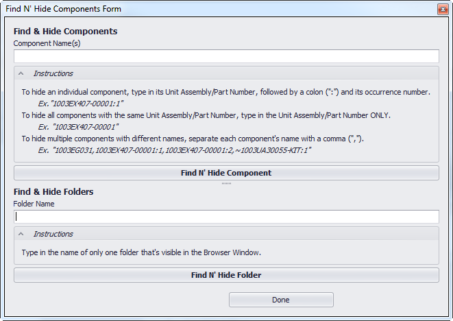

Like the instructions in the screenshot below shows, this tool will scan through and turn off the visibility for individual component occurrences in DrawingViews 1 - 5 on the shop drawing.  It can also turn off all components that share the same "part number", which is the name that shows up in the Inventor drawing's Browser Window.  On top of that, you can enter multiple part numbers into the Find & Hide Components textbox; just separate each name with a comma, and the sub-routines will find & hide each of the components that you've listed.  Lastly, the Find & Hide Folders textbox will find & hide all of the contents of a specified Browser Folder.

I threw together a simple User Interface Form for this "Find & Hide Components" tool, complete with instructions on how to enter the component names into the textboxes:

There's a couple of interesting things that I've learned while figuring out this tool.  First, Inventor gets angry and throws errors at you if you attempt to hide a component that doesn't contain any 3D models.  The engineering team at my company sometimes create these empty placeholder components in their assembly models solely to make some additional unmodeled components appear on the assembly's B.O.M.  I found that checking each sub-component's SurfaceBodies property helped to determine if it was something that's safe to hide.
Another interesting thing that I've learned was that the BrowserNodes in the Browser Window don't seem to have any direct connection to their counterparts within the assembly document.  My need for a tool that could hide a specified folder in each DrawingView required that I dig through the BrowserNodes to find the components listed within a BrowserFolder.  But since there's no BrowserNode property that directly links it to its component counterpart within the assembly model, I had to create a work-around method to solve my problem.
To solve my problem, I went about grabbing each BrowserNodes' FullPath property, Split()ing them up into a Variant array, and then extracting the part numbers & occurrence numbers of each component from the Variant array's last two elements.  I then used my FindAndHideComponents() sub-routine to seek out & hide all applicable components whose Name property matched the extracted part numbers & occurrence numbers.
I can bet that this really long-winded post might be about a topic that a lot of you may have already figured out a loooooooong time ago.  But with all of the google & forum-searching that I've done, none of them really had the solution to this problem that I was looking for.  I'd be happy to let this post collect a lot of dust digitally in the back of a server hard drive somewhere for the rest of human existence for one single reason - that some other beginner like me may come along looking for this same exact answer, and will rejoice in finding all of this info in a single spot on the internet.
So I'll just make this post, pat myself on the back, and give myself a Kudo for solving my problem and sharing with everyone else.  Enjoy!
- Vinny

Message 5 of 8
V_L_F
Greetings Jesper,
It most certainly should be easy to make things visible again.  I would make a copy of both the Sub FindAndHideComponents() & Sub CheckAndHideSubAssyComps() sub-routinea, rename them to something like Sub FindAndUnhideComponents()Sub CheckAndUnhideSubAssyComps(), and then change the following lines of code wherever they occur:
Here's the original If-Then statement that checks & turns off the visibility of the named component:
' Toggle visibility of components in subassembly.
If oView.GetVisibility(oCurrentSubAssyCompProxy) = True Then
    Call oView.SetVisibility(oCurrentSubAssyCompProxy, False)
End If
To unhide the named component, change the If-Then statement to this:
If oView.GetVisibility(oCurrentSubAssyCompProxy) = False Then
    Call oView.SetVisibility(oCurrentSubAssyCompProxy, True)
End If
On that note, I'd like to mention that I've made a slight revision to my Sub FindAndHideComponents() sub-routine.  I found that when my sub-routine is looking at a level 2 sub-component (which are referenced by the oSub2AssyCompOcc variable), I ran into an issue when that sub-component was NOT an AssemblyDocumentObject.  Essentially, I forgot to have my sub-routine check to see if the oSub2AssyCompOcc sub-component had a SurfaceBodies.Count of greater than 0.  If the current oSub2AssyCompOcc sub-component is an empty placeholder component (i.e. has no 3D model in it, and is only used for something like using its iProperties to populate a B.O.M.), the Sub FindAndHideComponents() sub-routine kicks up a run-time error.
Here's the revised sub-routine:
