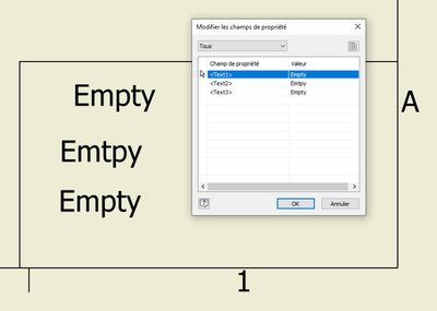

If ilogic can also be used to load data into a title block (or anywhere into a .dvg drawing sheet) from a .xlsx table? Thank you very much for the answer!

Hello @ProRuzneDrobnosti,
Yes indeed you can. I made a small set up with :
1. An Excel fine named TitleBlock.xlsx placed inside the active Inventor project
1.1 Inside a table with two columns : properties & their values
2. A custom title block with promts set with the same name as inside the Excel file :
Then, we can make a first function that will gather the information, and fille the titleblock afterward. Here is the sample code in iLogic :
Sub main
	Dim excelTable As Dictionary(Of String, String) = get_inputs
	Dim doc As Inventor.DrawingDocument = ThisApplication.ActiveDocument
	Dim titleblock As Inventor.TitleBlock = doc.ActiveSheet.TitleBlock
	Dim s As Inventor.DrawingSketch = titleblock.Definition.Sketch
	For Each t As Inventor.TextBox In s.TextBoxes
			For Each k As String In excelTable.Keys
				If t.Text = "<" & k & ">" Then
					titleblock.SetPromptResultText(t, excelTable(k))
					Exit For
				End If
			Next
	Next
End Sub
Function get_inputs() As Dictionary(Of String, String)
	Dim propertiesColumn As String = "A"
	Dim valuesColumn As String = "B"
	Dim firstLine As Integer = 1
	Dim lastLine As Integer = 3
	Dim excelTable As New Dictionary(Of String, String)
	For i As Byte = firstLine To lastLine
		Dim p As String = GoExcel.CellValue("TitleBlock.xlsx", "Tabelle1", propertiesColumn & i)
		Dim v As String = GoExcel.CellValue("TitleBlock.xlsx", "Tabelle1", valuesColumn & i)
		excelTable.Add(p, v)
	Next
	GoExcel.Close
	Return excelTable
End Function
Note the properties names  inside excel & the prompt names inside Inventor must perfectly match.
Does this suits your needs ?
Kind regards,
FINET L.

ProRuzneDrobnosti
Wow, it looks like this is what i wanted. I will try to figure it out. Thank you very much!
ProRuzneDrobnosti
Hello, can I clarify a little? It is necessary to read other data from .xlsx tables for each sheet. Thank you very much
ProRuzneDrobnosti
Hi again, is it possible to use similar code in ilogic to write to a table (General . ProRuzneDrobnosti_0-1708505939261.png)
(not titleblock) Thank you very much for your help!
