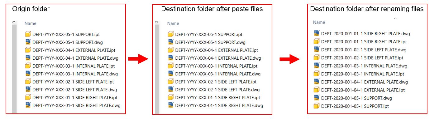

Attached there is an image simplified to clarifying to you how I imagine, is going to be the steps of copy, paste and rename the files.
The goal is the iLogic code execute the following steps:
The step number one is copy the template files from the origin folder
Step number two is paste the templates files in a folder indicated in the form (like mentioned in the first post)
Step number three is rename the files

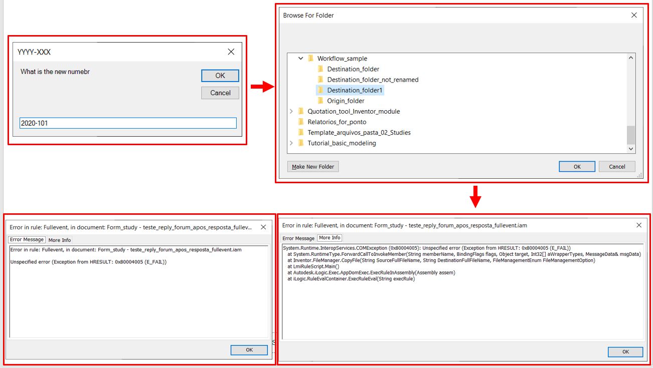

Message 10 of 26
moraesorlando
Hello @fullevent !
I have copied this code and pasted in a new iLogic rule in a assembly file.
After run I received the error message shown in attached file.
Maybe I have done something wrong?
Best regards,
Message 11 of 26
fullevent
Hello @moraesorlando,
it's VBA code not iLogic.
You can use it as a macro or transform it into iLogic.
I hope that is not a problem.
Let me know if you need any help.
Regards,
Aleksandar Krstic
Produkt- und Projektmanager

moraesorlando
Helo @fullevent !
Thanks for generate a code to iLogic, I am new in Inventor programming and not familiar with VBA inside Inventor.
So, I tested the iLogic code but I didn't succeed.
Following, the steps I past through:
1 - I have run the code and a dialog box were shown
2 - I have put the numbers 2020-101
3 - A dialog box for browse the files was shown
4 - I have indicated the destination folder to paste the files
5 - An error message were shown
Please take a look in the attached file with illustrations of each step.
Thanks and best regards,

moraesorlando
Hello @JhoelForshav  and @fullevent!
I have made two tests first I checked all the names of all the files to search for some spelling mistakes. I built a table in Excel and used a formula to check the spelling, and all the files names are correct with the names in ilogic code (see table below)
 Names in iLogic code without ""File namesVerification
sFilesToCopy(0) = DEPT-YYYY-XXX-05-01 SUPPORT.iptDEPT-YYYY-XXX-05-01 SUPPORT.iptTRUE
sFilesToCopy(1) = DEPT-YYYY-XXX-05-01 SUPPORT.dwgDEPT-YYYY-XXX-05-01 SUPPORT.dwgTRUE
sFilesToCopy(2) = DEPT-YYYY-XXX-04-01 EXTERNAL PLATE.iptDEPT-YYYY-XXX-04-01 EXTERNAL PLATE.iptTRUE
sFilesToCopy(3) = DEPT-YYYY-XXX-04-01 EXTERNAL PLATE.dwgDEPT-YYYY-XXX-04-01 EXTERNAL PLATE.dwgTRUE
sFilesToCopy(4) = DEPT-YYYY-XXX-03-01 INTERNAL PLATE.iptDEPT-YYYY-XXX-03-01 INTERNAL PLATE.iptTRUE
sFilesToCopy(5) = DEPT-YYYY-XXX-03-01 INTERNAL PLATE.dwgDEPT-YYYY-XXX-03-01 INTERNAL PLATE.dwgTRUE
sFilesToCopy(6) = DEPT-YYYY-XXX-02-01 SIDE LEFT PLATE.iptDEPT-YYYY-XXX-02-01 SIDE LEFT PLATE.iptTRUE
sFilesToCopy(7) = DEPT-YYYY-XXX-02-01 SIDE LEFT PLATE.dwgDEPT-YYYY-XXX-02-01 SIDE LEFT PLATE.dwgTRUE
sFilesToCopy(8) = DEPT-YYYY-XXX-01-01 SIDE RIGHT PLATE.iptDEPT-YYYY-XXX-01-01 SIDE RIGHT PLATE.iptTRUE
sFilesToCopy(9) = DEPT-YYYY-XXX-01-01 SIDE RIGHT PLATE.dwgDEPT-YYYY-XXX-01-01 SIDE RIGHT PLATE.dwgTRUE
The result of the second test it's much more interesting.
I ran the code from @JhoelForshav  an received the information about issues in all other files (except those two that is working), and clicked ok in each message and as result, all files were copied and renamed correctly to the  destination folder. Exactly as we desire.
Looks like the verification lines made by @JhoelForshav does the code reinitiated and copy the files.
I don't understand all lines in the code but I think we are almost there.
Something after the message make the code run correctly.
Maybe is necessary remove the message and keep the verification lines that is working.
Once more thanks you two.
