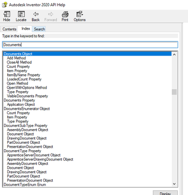

Message 8 of 11
A.Acheson
I think you may have looked in the wrong location. Required was the DocumentTypeEnum class.
And from the API help search documents, properties -DocumentType, click to documentTypeEnum
Or alternately in API Help API Navigate through fly out tabs  >Reference Manual>Enums>DocumentTypeEnumsEnums.
This document type method doesn;t have a physical smaple in the help docuemnt so it isn't that clear on how to use it. But for these workflow gaps looking to the  forum to produce a sample helps a lot then you can backtrack and find the path used.
Here is a link to API Object Model. However I am not sure why it is not listed under documents.
https://knowledge.autodesk.com/search-result/caas/simplecontent/content/autodesk-C2-AE-inventor-C2-A...
Regards
Alan

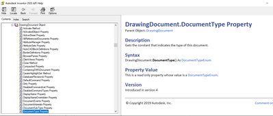

Message 10 of 11
A.Acheson
In this case for me it was just something I have picked up while search posts. I suppose enough time working with the help documents and having some training in terminology of programming would help also.
Another path is DrawingDocument>DocumentType>DocumentTypeEnum
or from the API help Drawing Document
As regards knowing to check the document collection (group of document) called documents. I think this is
something that has to be picked up.  The object model diagram doesn't have everything  included so the help file is needed. I have just found that the index works well for seeing the hierarchy.
Regards
Alan
