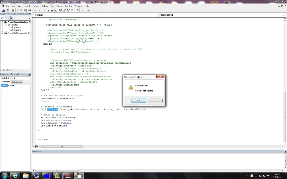

в ответ: Anonymous
I've tray to execute the VBA code but it give me this error:
Сообщение 20 из 40
в ответ: Anonymous
I don't be able to find the error.
P.s. I need only adobe PDF script not the netive PDF creator.
