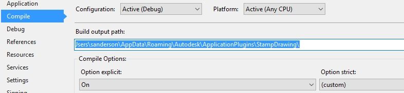

You need to ensure ,that you copy dll(s), local resources (if any) and the *.addin file to one of the Autoloader Search Folders.
Here are some of them (there may be more)
%Appdata%\Autodesk\Applicationplugins\
%Programdata%\Autodesk\Applicationplugins\
%Programfiles%\Autodesk\Applicationplugins\
%Programdata%\Autodesk\Inventor 20xx\Addins\
%Programdata%Autodesk\Inventor Addins\
Each of them may have slightly different loadbehavior (%Programdata%\Autodesk\Inventor 2014\Addins\ loads for 2014 only e.g.)
Anyway, I tend tu use APPDATA, since this is a per-user distribution. After Compiling I juts have my files there

I have selected two options for my project properties.
1. I have specified a build output path for the project with regard ro the compilation.

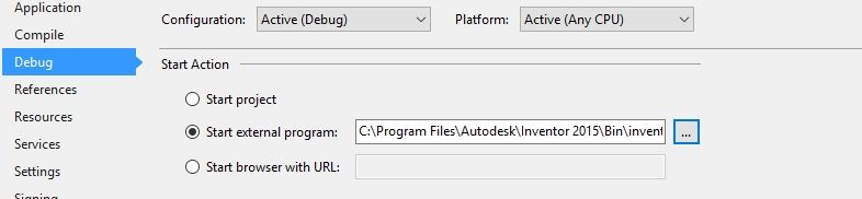

2. Under debug, I have specified to start an external program, ie: Inventor 2015
The program is: C:\Program Files\Autodesk\Inventor 2015\Bin\inventor.exe

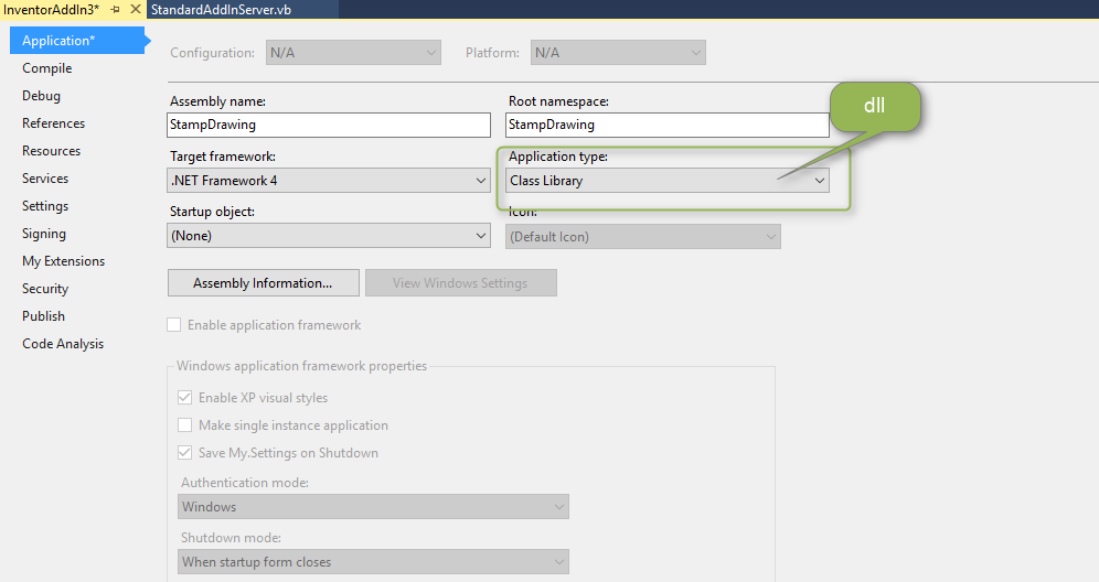

 Hi Stephen,
attached the reviewed VS-Project. Now it should compile.
I made following modifications:
1. Setting Project Type
to:
2 edit post build
to
Additionally there was some incorrect path info in your .vbproj
Now your project builds. However I could not see any UI-Implementation, so you won't be able to start your function at this stage.
You will need to define a button (commandcontrol), which the user can click on. In the Onexecute method you can call your business logic...
