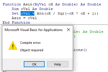

I've also tried your method but unfortunately it didn't work for me:

Just wanted to mention: The reason the code of @WCrihfield gives an error is because of the 'Set' statement in the 2nd line of code. This statement is not required, since 'oVal' is not an object (it's a double).
