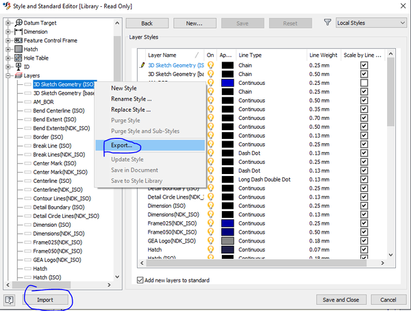

inventor custom color on the drawing
I want's to create pre-defined list of customized colors  for drawing edges(lines).
Issue with I have is that when I create customized color after restart of Inventor the list is blanc.
Questions:
1. Is there any possibilities to save created customized colors ?
2. If yes with file is responsible to keep this settings ?
BR,
Łukasz Dudkowski

@Lukasz.Dudkowski
 I think you can edit the style library and save your desired colors for lines. After theat you may export the settings file and use for different drawings. Moreover, it may stay intact when you make this drawings as a templet file.

SharkDesign
in reply to: bhavik4244
Bhavik method won't save the custom colours in the pallet you show, but it will save the colours associated with the layers allowing you assign objects to them.

@bhavik4244
Thanks for yours advise, but I will want's to have solution where I perform modification only of the line color. I avare that with your solution I will need multiple layers with multiple colors with will case a little bit of mess.
