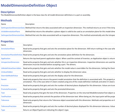

I Assume that the Sketch Dimension (DimensionConstaint) and the Model Dimension (ModelDimension) are somehow connected.
I was checking the documentation, but i did not find any connection between the two objects.
Can somebody help me to find the connection between these objects, or how can i find out if one DimensionConstraint is already promoted and get the object ?!

Within the Modeldimensiondefinition you can find the promoted parameter. But for some reason i can't get the parameter. It results in a "not implemented" message. Maybe someone else knows how to deal with this.
Dim oDoc As PartDocument
oDoc = ThisApplication.ActiveDocument
Dim oDef As PartComponentDefinition
oDef = oDoc.ComponentDefinition
Dim oModelDim As ModelDimension
For Each oModelDim In oDef.ModelAnnotations.ModelDimensions
Dim oModelDef As ModelDimensionDefinition
Dim oPara As Inventor.Parameter
oModelDef = oModelDim.Definition
oPara = oModelDef.PromoteParameter
Logger.Info(oPara.Name)
Next

With Inventor 2022.2 update it's now possible to use "Promoteparameter". tested it and it works fine :slightly_smiling_face:
