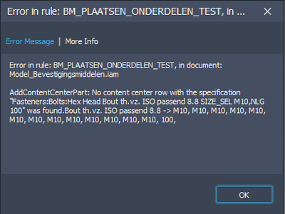

I hope you can help me with this. I cant get my code to work in a external rule. I am using the same sample code as you are and it is not working. The error i get when i run de code is this:
(the more info tab is in the attachments)
it seems like it cant find "M10" but if i run the exact same code in a normal rule (not external) then it runs just fine. So that means i dit not make a spelling error. I have no idea what i am doing wrong. can you (or some one else) help me with this?

Dim Bolt_1 = Components.AddContentCenterPart("M10x100", "Fasteners:Bolts:Hex Head", "Bout th.vz. ISO passend 8.8", {"SIZE_SEL", "M10", "NLG", "100" },
position := Matrix_bolt_1, grounded := True, visible := True)
thanks in advance,

@FrankHermens4Y53K , it sounds like you have to add code to explicitly set the Content Center language. That is used for the path ("Fasteners:Bolts:Hex Head" in this case). Please try adding this line to the top of your rule:
Components.ContentCenterLanguage = "en-US"
This is documented here

@MjDeck, thank you very much, that was ideed the problem. no wonder i could not find the problem, i had no idea this was a thing.
