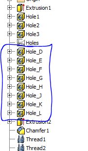

Yes you can subtract a value from the hole count to give you the count you need (if this is workable for you) otherwise you can do some checks against the hole name.
For example, if you named the holes that need counting "CountMe Hole 1" / "CountMe Hole 2" etc. you could do :
NoOfHoles = 0
For Each HFeature As HoleFeature In ThisDoc.Document.ComponentDefinition.Features.HoleFeatures
	If HFeature.Suppressed = False Then
		If Left(HFeature.Name,7) = "CountMe" Then
			NoOfHoles = NoOfHoles + 1
		End If
	End If
Next HFeature
iProperties.Value("Custom", "HoleCount") = NoOfHoles
Which will only add the hole to the count if the first 7 chars are "CountMe"

Holes I would like to have count if active and remove from count if inactive

Im not sure why it didnt work first time, I re copied the code back in and now its working.
I also added a line that checks if the last char of the hole name is a number - if it is a number then it doesnt get added to the count.
Hope this works OK for you.
Message 19 of 23
